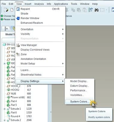

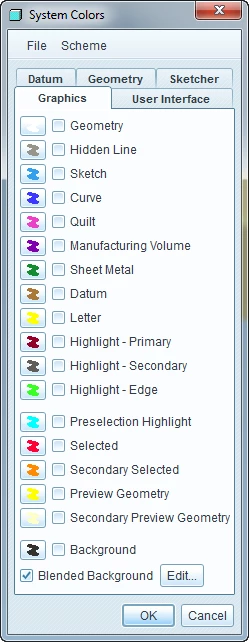

September 14, 2012
Hi all,
Kind of a stupid question but haven't been able to figure it out.
Can anyone tell me where I can change colors in Wildfire 5, specifically background, text color for drawings, etc?
Never had to do it in WF2 which we're slowly moving away from.
Seems like the obvious place is system colors, but is there a specific file within the WF5 program files that controls the color scheme?
Stefan
September 14, 2012
The color settings are stored in your syscol.scl file. These changes can be made in the area below.

Make sure to save the file for reuse.

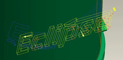

I'm curious, how would I create a logo wrapped around a cylinder. I've
done some logos on curved surfaces before where I could actually extrude
the logo nearly perpendicular to the surface, but how would I do it if
the logo goes all the way around the cylinder. I obviously can't make
an extruded feature from that because its curved (wrapped actually,
around the cylinder...)
Toyn
September 14, 2012
Tony,
I would try using the wrap feature. Using the wrap feature you can get curves
put onto the cylinder all around. Then if you need to cut into the part or add a
protrusion off the surface then use the offset feature and choose whether you
want the feature normal to the surface or normal to the sketching plane, etc.
You might have to do this from 2 to 4 different directions to cut or protrude
your logo. See attached file for reference.
Good luck,
Mark A. Peterson

September 19, 2012
OK, here’s my summary (prompted by Terry, 😉 )
I used the last option pretty much… here’s the details on my actual procedure...
1. Wrap the logo around the cylinder (this can actually be skipped if the logo doesn’t go too far around the cylinder)
1. Offset the cylinder outer surface towards the inside the depth that I want the logo to be cut to
2. Create a surface tangent to the cylinder at the center of my logo
3. create a protruded cut, using the outline of the logo sketch (use edge), protruded up to the new surface…
End product…
Note, the cut is perpendicular to the sketch surface but for my prototype this won’t matter. On the final part, I’ll not have this cut in anyway.
Tada!
Tony

September 21, 2012
Wrap onto cylinder
on tangent plane, create sketch from wrapped curves with 'use edge' tool
use the sketch in offset surface feature - side surfaces normal
This method can be used for 'wrapping' onto non cylinder 3d surfaces by wrapping onto a cylinder which approxiamates the 3d surface
