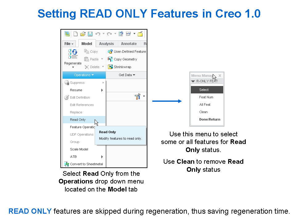

Hi David...
Your maintenance firm is incorrect. The Read Only feature can do precisely what you're asking. This feature has been around for at least 15 years. See the graphic below for more details. If you have 30 features and you select feature #15 to be Read Only, all features before it automatically become Read Only, too.
If you wish to remove Read Only status, use the Clean command (also on the Read Only menu). Click the image below for a larger graphic.
Thanks!!
-Brian
January 4, 2012
It occurred to me after re-reading your initial message that you said you were using "Creo" but I assumed that meant Creo 1.0
The same command is available in Creo Elements/Pro (Wildfire 5) by selecting Edit>Read Only from the top level menu in model mode (as opposed to drawing mode).
Thanks again! Hope that helps...
-Brian

Nice one Brian, that's perfect.
