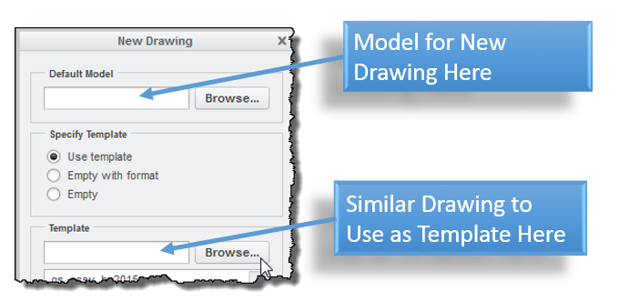

For now, your best bet is to use an existing drawing as a template for future drawings with similar requirements. To explain, let's say you're a bicycle manufacturer. You need to create several "bent tubing" drawings which always use the same notes and similar views.You also create several drawings of sheet metal components which are bent and formed to create fenders and the platform for the bicycle seat. You also create numerous drawings of the tires containing specialized notes, a cross-section of the tread, and various other data unique to the "tire" drawing.  By starting with 3 drawing you've already created, you can develop "templates" which allow you to rapidly create similar drawings in the future.
Literally the easiest way to do this is to load an existing drawing as a template at the time you create your new drawing.
Create your new drawing. Select the Use Template button and choose Browse to select an existing drawing with characteristics you'd like to reuse. See below...
Any views on the previous drawing should be duplicated preserving notes, bills of materials, symbols, and views. If memory serves me correctly, the new model will replace the existing model, too - and all views will appear. I realize there are ways to add preset views to a blank template using special symbols, etc. You may want to go that route -but try this first.
