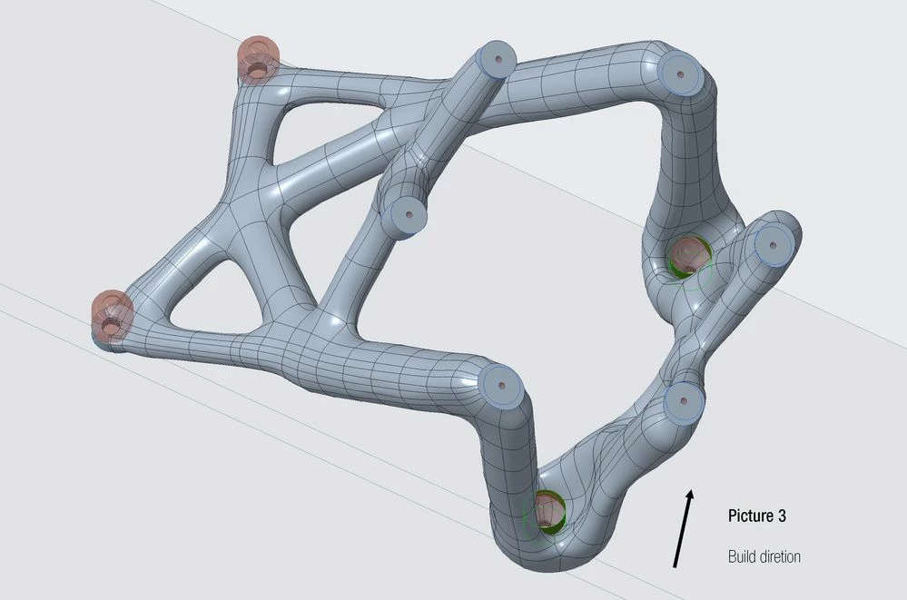

I am trying to create optimized parts for AM. During the initial optimization (pic 1), the part looks very good and respects the Excluded Geometry bodies, ie. keep out areas.

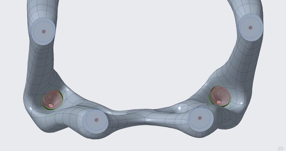

However, when I generate the result to reconstructed part (pic 2), it will create shapes intersecting with Excluded Geometry areas. In this example, I cannot attach the required fasteners to final design since the organic blobs are blocking it.

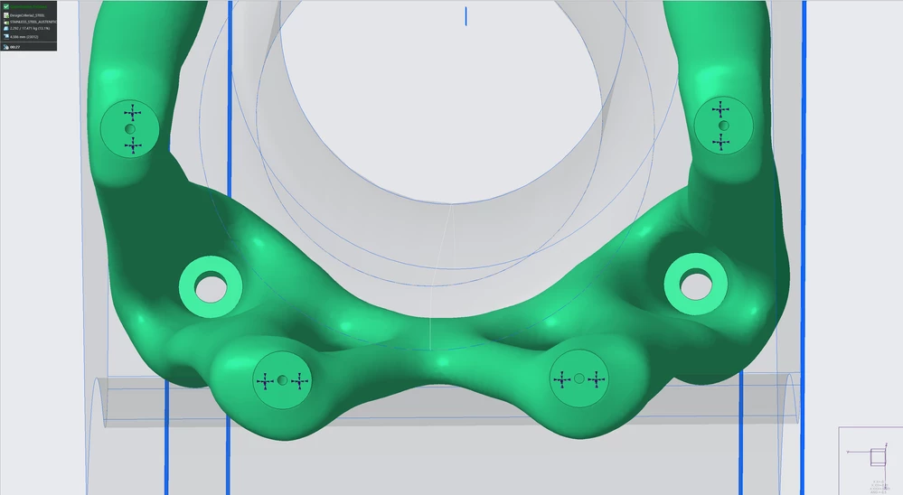

I thought that build direction could have something to do with it, so I flipped it to not have any internal "ceilings", or bridging, in the design. Same result (pic 3).

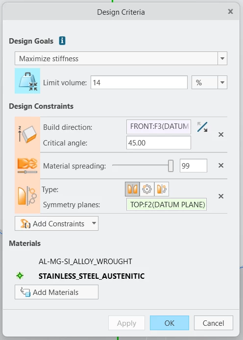

I have tried to change material, material spreading, forces, output resolution level, excluded geometry design etc (pic 4). The same challenge repeats, final reconstructed design does not respect my excluded geometry.

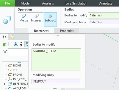

Hi @JSar
I use Creo 11, and I had the same hole issue you did.
I recommend that you use the Boolean operation to remove the excluded geometry (KEEPOUT body) without using it in GD.
When I tried this technique, I did not encounter your problem.
Please note you Preserved geometry is partially outside the starting geometry. This is something you should fix, but it has no bearing on the hole issue you raised in the topic.

Hi Dale, those plus-looking objects are symbols for the Fixed Constraint. They are for the preserved geometry and in the edge of my Design Space. If you compare the initial optimization result in green (pic 1) and reconstructed part (pic 2), the have no problems at all.
It's the red parts, excluded geometry that is the challenge. The reconstructed part will always overlap with them
