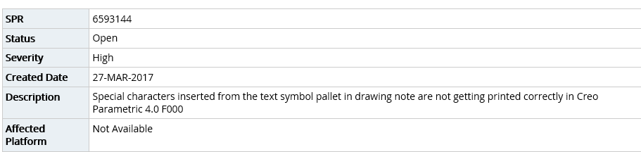

I've recently upgraded from Creo 2 to Creo 4, and discovered today that when exporting drawings to PDF, the geometric tolerance symbols disappear in the PDF. The boxes, tolerance and reference datum all show like normal, but the symbol itself (parallel, perpendicular, flatness...) are blank. I've tried all settings within the export and still nothing. Doubt it's a layer issue (or the whole box probably wouldn't show up).
Also, I used to be able to make a note to denote a datum, usually insert>note ; then type "@[-A-@]" to give a nice datum box around "-A-" but that seems to have disappeared too.
Any ideas on either? Thanks!

There is some issue with Creo 4 and printing fonts. Cannot figure out why when we plot our drawings our symbols show up below the text or at the bottom of the dimensions? H…
The last post is from PTC tech support and it's supposedly fixed in M020 build code.
StephenW
May 9, 2017
Wrong one...https://support.ptc.com/appserver/cs/view/spr.jsp?n=6593144
It's this one that the symbols in notes are not printing. Says the are still evaluating the problem

I did get them to print using the "Stroke All Fonts" option. which I suppose will work for the short term, just gives an inconsistent look to all my old drawings compared to new.

As Stephen mentioned it was a known bug and has been corrected in upcoming M020. You may mark Stephen's reply as correct answer to post.
