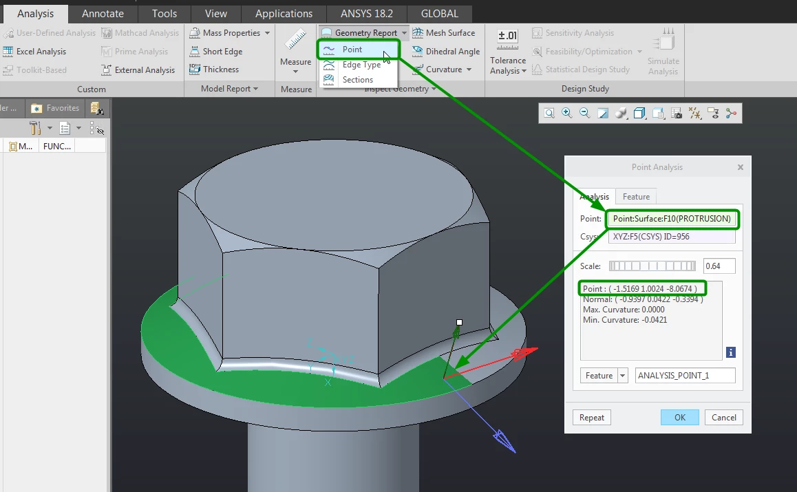

November 7, 2017
The easiest, most diect way I can think of to extract coordinates of a randomly selected point on a surface is to use the Geometry Report > Point tool.  Just click on a surface and it tells you the coordinates of where you clicked as well as the surface normal and curvature.
If you save that Point analysis as a feature Creo will create parameters of those values.  It will also create a coordinate system at the point which would contain the actual coordinates.
