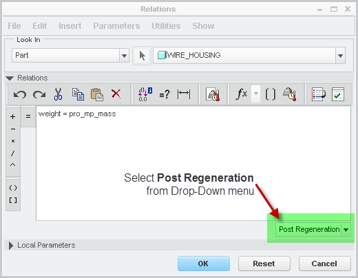

Does anyone know how I can get a mass property weight to show up in a title block? I'd like to see the part weight show up in the drawing, and potentially see the full weight of an assembly printed in the title block as well.

Hi
There is a system parameter for it pro_mp_mass
There are two ways for getting it in drawing
1.Use it in a part/asm template relation
eg- Weight=pro_mp_mass
and use Weight parameter in drawing format table(title block table) as &weight
2.Directly use this in drawing format table(title block table) as &pro_mp_mass
You can reduce decimal places by using &pro_mp_mass[.3]
But remember to set one config option
mass_property_calculate automatic
By setting this value system will automatically calculate wt upon regeneration.

Be careful using:
It means the part or assembly is automatically regenerated a lot, marking the files as changed in Windchill, causing issues on check in. After using that setting, and encountering problems, I think a better setting is:
mass_property_calculate by_request
This means it's only done when you do a mass prop in the model. Then just update your dwg and it's fine.

Even though the automatic setting may be convenient, it usually causes more headaches than it solves. I prefer keeping mine set by_request and taking responsibility for making sure the drawing is updated. Honestly once you've run the mass props calculation ONCE, I find I don't have to bother checking to make sure the drawing is updated- it's just done automatically.
Two things I would add to Kshetrabasi's post...
I would move the relation weight=pro_mp_mass into the "Post Regeneration" area of the relations. This way the weight is calculated after any dimensional changes to the model are incorporated. This prevents the dreaded "double-regeneration" problem and insures your weight parameter is always correct. See below...
The second thing is to always make sure you've generated the mass properties report at least once by hand if you're using by_request. In Wildfire 5, go to File->Properties->Mass Properties and select Generate Report. In Creo 2, go to File->Prepare->Model Properties to access the Generate Report button. You must generate the report manually one time before your mass properties values will update.
This sounds like a pain in the neck and a good reason to choose automatic, but I still believe there are more downsides to using automatic than the slight inconvenience of running an initial mass properties report.
