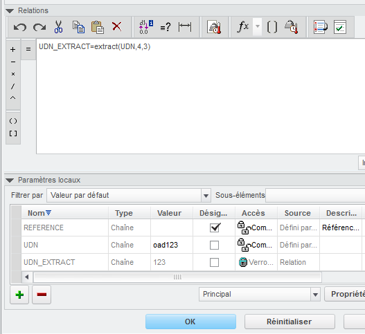

If i understand your problem,you can extract value of parameter with extract() function ( in relations )
Exemple ( see screenshot 😞
UDN=oad123
UDN_VALUE=extract(UDN,4,3)
The first number is the start position, the 2nd is the number of charaters to extract
Hope this help you

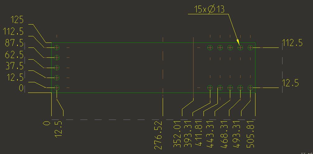

I have this sheet metal part that its unbend state as shown in the drawing as below:Capture1.JPG

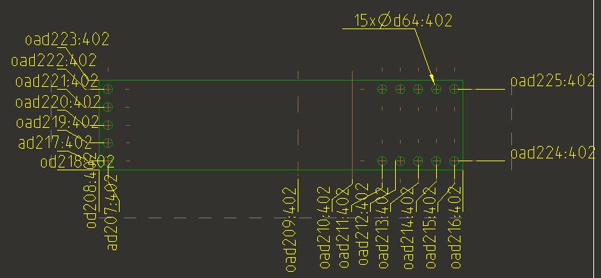

If we toggle the dimension will be pictured as below:
So, The unbend length dimension is 505.81 mm or can be described as parameter "oad216", where the "216" string value is equal udn. This value will be entered manually.
