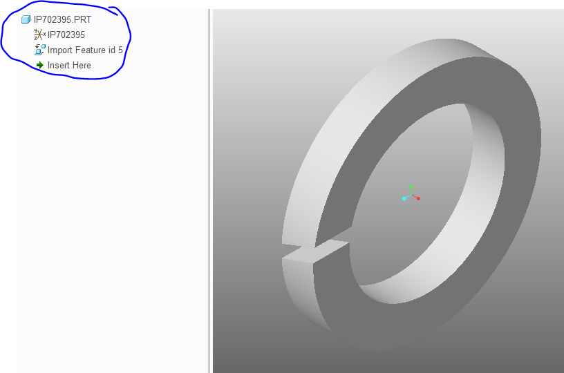

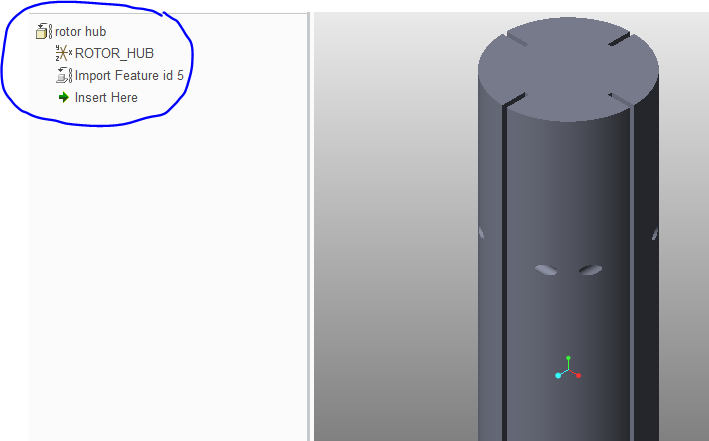

Hi Rohit, Thanks for your quick reply, to clarify on my first question, I'm asking if Inventor files will be handled the same as SW, in terms of ATB/model updates, etc. I'll include 2 screenshots, Solidworks then Inventor, spot the difference. Regards, Ed
January 23, 2015
which maintenance version of creo 3.0 are these screeshots from?
the information i gave above is as per the PTC presentation.
Creo 3.0 M020 should be able to open and not import Inventor files.
