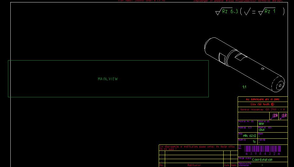

Green box in drawing in place of the actual view of the model.

Has anyone had this show up in a drawing? I don't know what happened to my detailed view and I can't even select the green box to do anything with it.

October 8, 2014

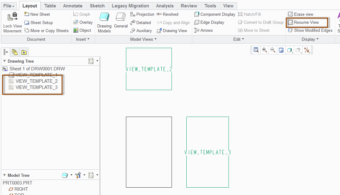

It looks like you erased the view called "MAIN_VIEW" - you can confirm this if in the Drawing Tree, the view name has an icon that is grayed-out.
If that's the case, you can resume it right-clicking its entry the Drawing Tree list and selecting "Resume View".
Or, switch to the Layout tab, then in the "Display" section, select "Resume View".

"Resume View" is not an option. Delete is my only option from here.

As Paul mentioned view which is in green (Main_view) is an erased view. To display this view, you need to resume the view using Layout Tab > Select View > Resume View or simply select the view name in drawing tree > RMB > Resume view.
Erase view functionality is basically to increase the performance when working with large drawings.
October 9, 2014
Your view might be missing a reference. Review the view properties and see if something is missing.
This is an unusual case since resume doesn't work.
