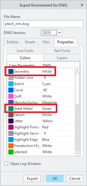

Green lines from sheet metal
I would like the green lines from sheet metal to either be black on white background or white on black background.
From this post:
https://community.ptc.com/t5/System-Administration/Config-pro-option-to-change-color-of-export-to-DWG-s/m-p/569354
I can see where I turned everything to black and white, but the sheet metal lines still turn up green.
Any thoughts?

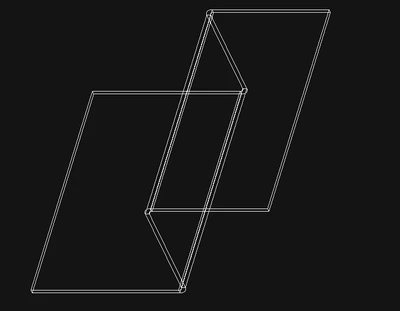

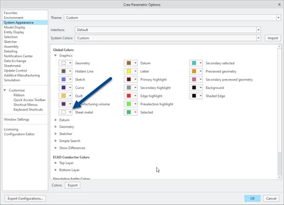

I think you can change the display of sheet metal in the options menu.
It does seem like this doesn't work exactly like I thought though. When I set the setting to white, the driving surface of my sheet metal part displays with white edges. The other edges don't though.
I thought that this might be related to the default appearance of my start part being green. I changed that next. I also added a few flanges to see what happens. This is the result:
Here's the drawing display as well:
I think this might be what you want but you'll have to play with it yourself.

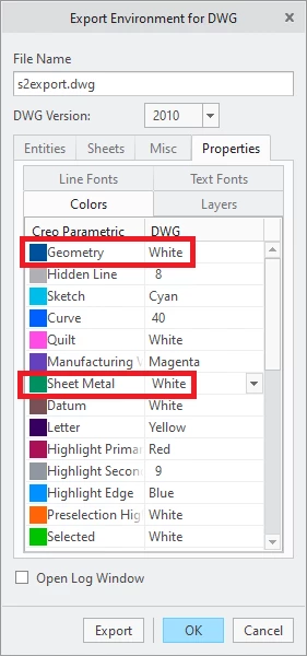

Dale_Rosema
Nov 22, 2022 8:02 PM UTC
So far from what I can tell this has solved the issue with green showing up in .pdfs.
Nov 18, 2022 12:11 PM UTC
Creo 7.0.5.0
s1export.png >>> dwg file in s1export.zip
s2export.png >>> dwg file in s2export.zip
