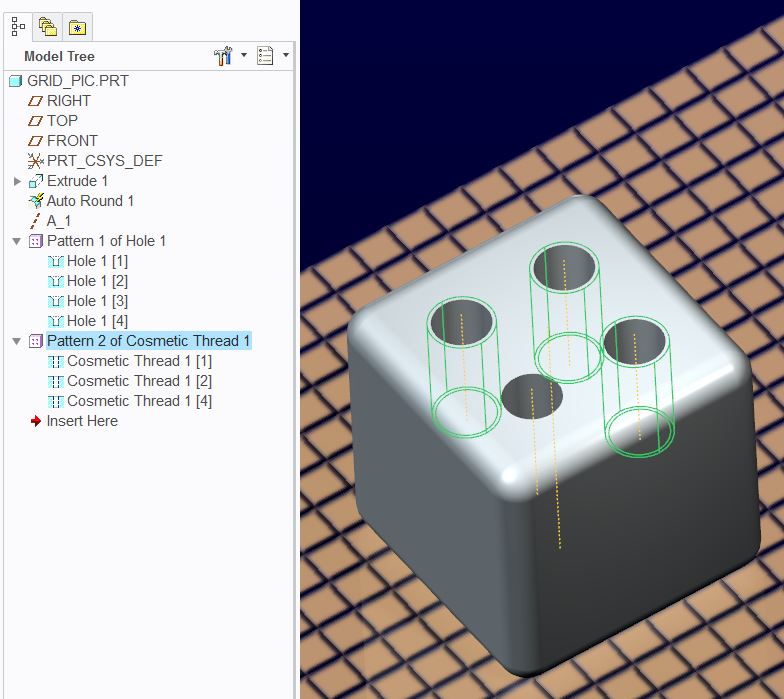

I see. Yes, if feature is a sub-feature it becomes part of the pattern and it is more difficult to remove. For "simplicity's sake" I would make a separate feature for that one hole. Cosmetic threads is not one that lends itself to being a stand-alone feature although it could be (old world).
I was able to make a hole in a pattern, then followed up with a reference patterns and omited one. Remember that you have to use the original to create a cosmetic thread to pick up the reference pattern.
