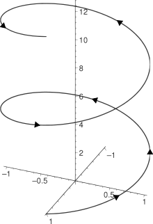

To create your helix using an equation you pick the "Insert a datum curve" icon, choose From Equation, select your Csys, and choose the Cylindrical option, then enter the following 3 lines:
r=1.5
theta=x*t*360
z=4.0*t
Save the equations and complete the feature.
The key to all of this is that "t" varies continuously from 0.0 to 1.0 from the beginning to the end of the curve. You may remember this type of parametric definition from high school Trig or Analytical Geometry.

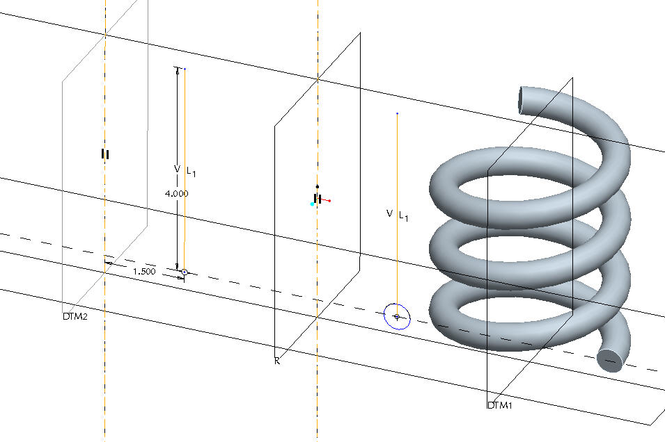

More on creating a spring using Helical Sweep. This illustrates the stages in the process.
First you sketch a centerline and another line to define the "profile" of your spring. In this case it is a simple "vertical" line but it could be slanted or even a wavy spline. What happens behind the scenes is that that line gets revolved around the centerline to create a virtual surface on which the helical sweep is progressively developed. When you finish that sketch, the system will automatically put you into a position to sketch the circle at the Start Point of the profile-defining line or curve. Finish that and you have your spring. The system asks for Pitch, not Number of Turns, so you have to divide total height by number-of-turns to get your pitch value. Note that you would use Thru Axis if cutting a thread, and Normal to Trajectory for a spring.
