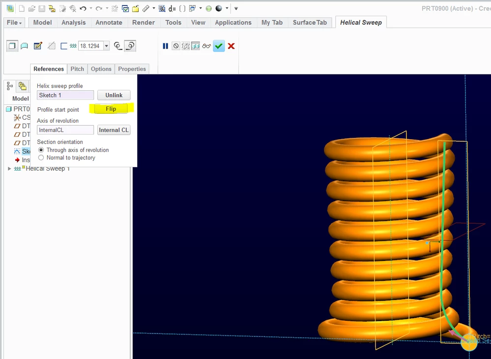

I'm doing a helical sweep based on an arc.line.arc profile.  The start point is not at the end of the arc.  I am trying to right-click to get the "startpoint" option on the side menu.  But I cannot get it to display.   Very frustrating because last time I did this, it came right up.
Is there some trick to this?

Look for a non-tangency.  Or you didn't get the intent edge and only got the single arc.
If your origin has more than 1 segment, you can use the shift key to add more.
Honestly I didn't know there was an actual button for the start.  I just click the pointer.
edit:  Aha... flip 😉

I did just discover that a left-then right click on the point I want to use as the start does bring up the menu I needed.
Weird stuff.
