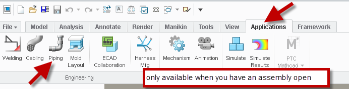

I was under the impression that the student edition had most of all the options already added. (although that may be the educational edition).
Piping is available as an option on when you have an assembly open. Create a new assembly, go to the applications tab and see if you have PIPING as an option.

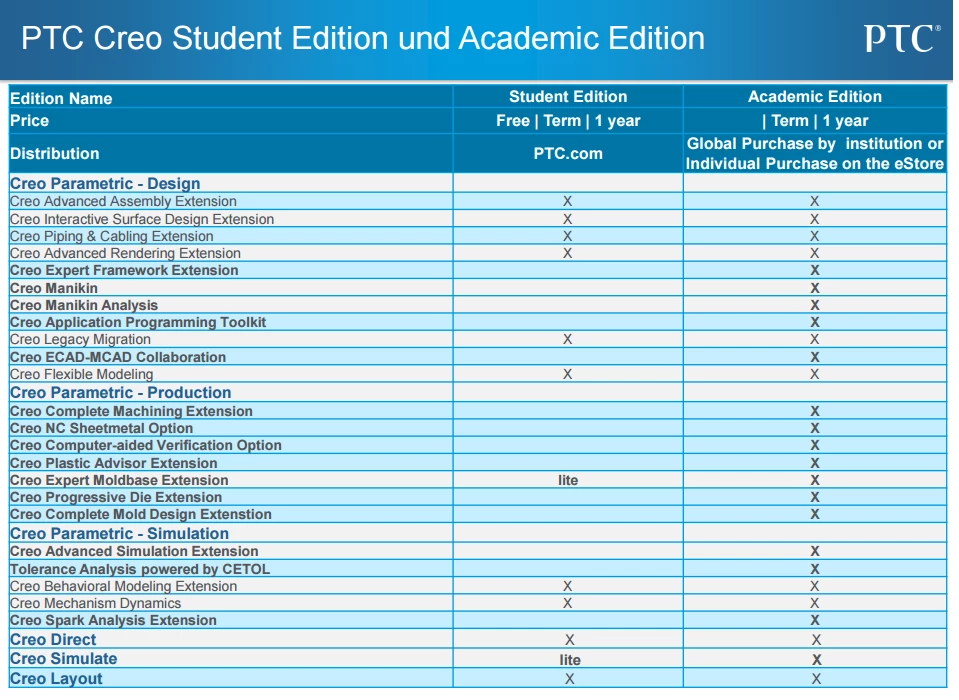

Creo Student Edition uses a license with limited set of modules. I am almost sure that Piping module is missing in Creo Student license. You have to use Academic license - it could be available at university lab.
MH
August 17, 2016
Here is a comparison of Creo Student vs Academic Edition versions:
