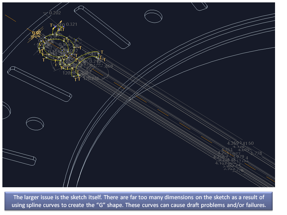

Hello! I am having trouble adding drat to the left side of the "g" feature on this part. I use this same extrusion on other parts and it drafted fine. I don't know what I am doing different... I need to add 2° draft in the same direction as the right side of the "g". Can anyone tell me what the problem is? I can add radii or change the size slightly if that helps???

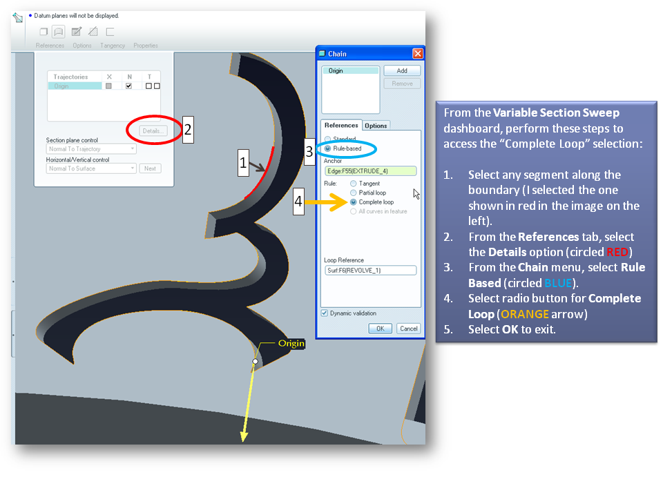

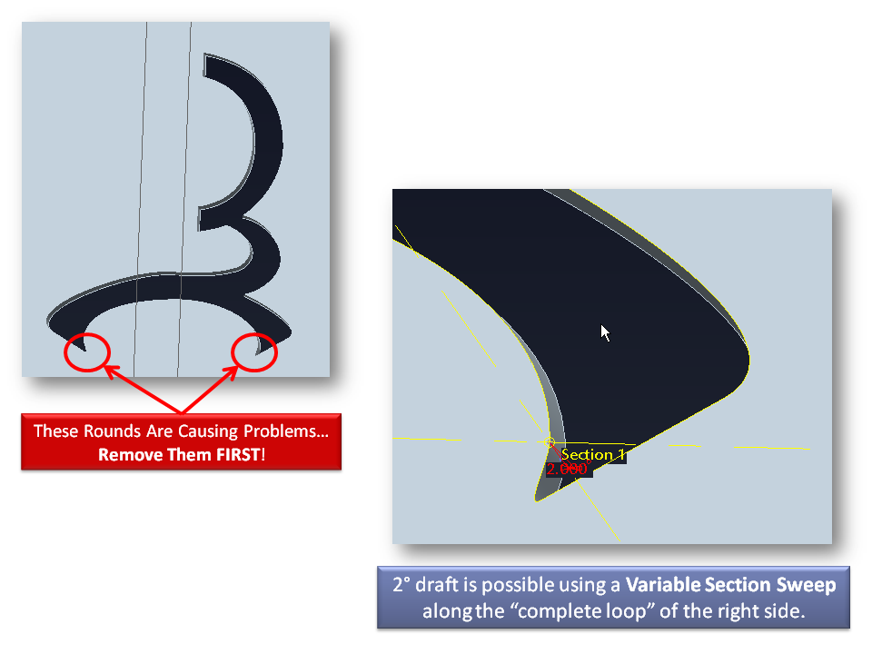

I managed to draft the surfaces you were having problems with by using a Variable Section Sweep. First, I had to remove the micro-rounds in the corners (see slides below). I used the Complete Loop option of a Variable Section Sweep (VSS) to achieve this. I detailed the steps to accessing this option below.
Your geometry is the real culprit here, though. I realize you're trying to use a stylized piece of geometry- like a logo. These are often very "swooshy" and artistic looking with lots of curves and splines and conics. From experience I can tell you Creo can't always handle drafts on these surfaces due to the self-intersecting nature of those drafts. for example, in those tight "turns" (especially the ones circled in red below featuring the rounds), drafting becomes very tough.

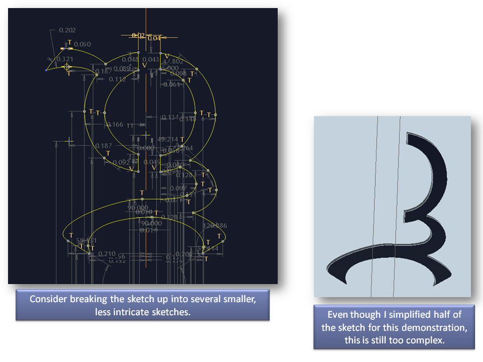

You're going to have a tough time with a logo-like sketch. It's always going to be messy with far too many controlling dimensions. My best advice would be to spend time simplifying the sketch. Try to generate the shape you want with as few dimensions and as little "crazy geometry" as possible. This will likely take some time but the payoff will be functional draft without the need for a sweep or surface geometry to create the piece you want.
Take a look at the slides below... click them for a larger, more readable image.

I've had similar probkems as Brian describes with complex logo's. There were times I had to import the entire logo (from autoCAD), and let sketcher create a zillion dimensions simply because there was no way to accurately do it one letter/figure at a time. I WISH there was an option to import geometry as a "block" like an AutoCAD block where you only get the option of scaling and/or rotating the whole thing. THAT is a much needed feature. But, what I find helps, is go into the sketcher options and turn off all the automatic constraints BEFORE you import the sketch. this prevents the sketcher from assuming almost everything, and just creates the mentioned zillion dims. Then set the selection filter to "dimensions", highlight everything, and lock them. Then, if there are any constraints, set the filter for that and make them strong. It's not perfect, but it definately helps.
As he mentioned, the more complicated the geometry, the more trouble you'll have adding draft to it. And, also, in 99% of cases, rounds should always be added AFTER draft anyways, because of tooling issues (ball-end milling cutters, etc.).

EDIT: I've just tried Brian's method and the sweeps created the draft cuts with no problem. All I needed to do was to set the model accuracy to absolute 0.0005.
