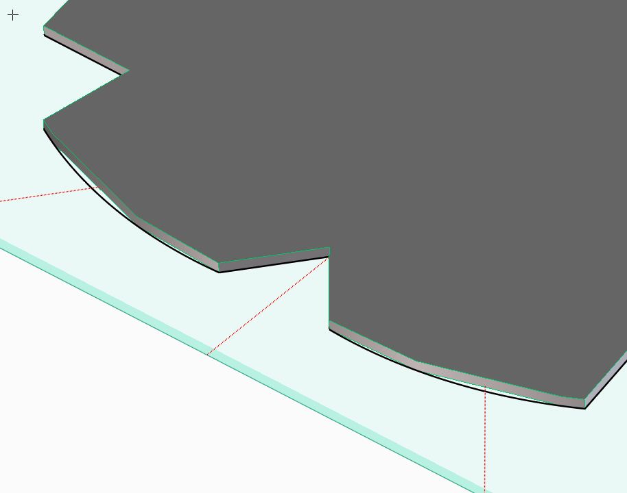

I have been trying to pull a sketch of a few curved surfaces from a wp into a part (please see below), but the curved edges come out very jagged. I'm sure this has something to do with a display setting. I just can't find it. Any help is much appreciated.
Ross

Part Properties --> Facets
But that is not a display setting --> the file of the part gets bigger.

Thanks! Worked great.
