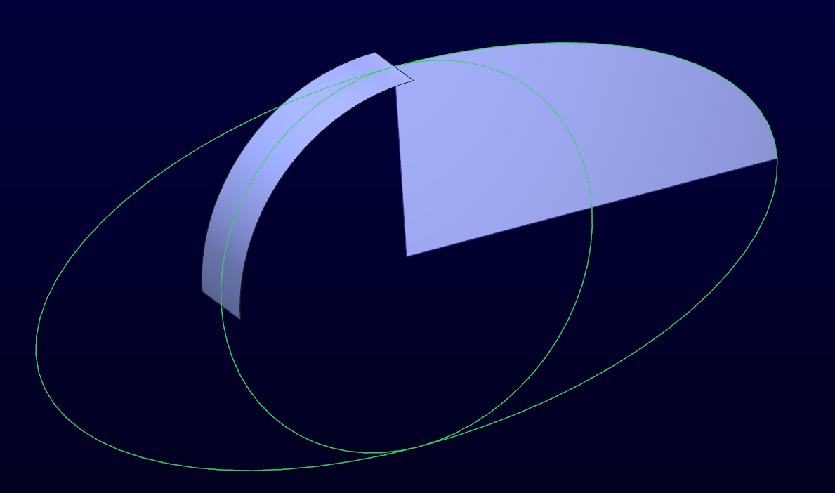

How do I "define" a semi-circle by an equation when Y is linear?
I know the cartesian formula:
x = 4 * cos ( t * 180 )
y = 4 * sin ( t * 180 )
z = 0
But I need to compensate for the trajectory (Y) which has a linear value.
I need the formula applied only to X given Y is linear 0-1.
I want to sweep a VSS to make this shape. The trajpar is the given value (t as Y):

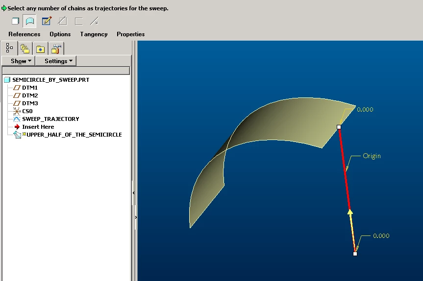

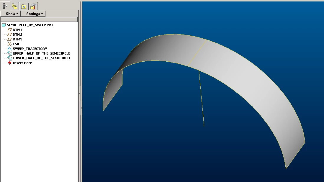

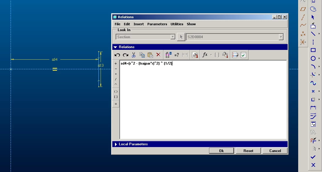

Dear Antonius
I have tried to create SEMICIRCLE BY SWEEP feature - it is working (you can investigate my model)
Note: I have used for sweep feature the Relation (for UPPER_HALF_OF_THE_SEMICIRCLE) sd4=(r^2 - (trajpar*r)^2) ^ (1/2)

Dear Antonius

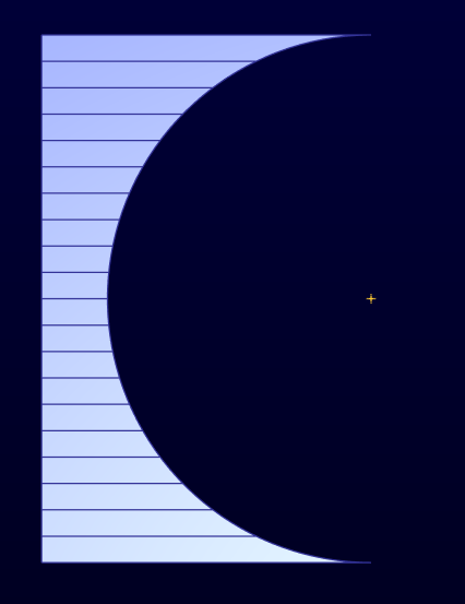

June 19, 2013
That's the one! I suspected I would have to divide it into quarters.
Here is the simplified "on the fly" version: sd4=sqrt((5^2 - (trajpar*5)^2))
And as a bonus, it covers ellipses
Thanks Vladimir!
