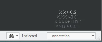

Current limited method of manual edit: with tol_display on some of the items are in the lower right corner of the graphics window. Have to set selection filter to annotations. Then double click on item. Enter new value to. Enter. Repeat for the few listed.
Current method to update all manual method:
Add a note and input the parameters:
&linear_tol_0_
&linear_tol_0_0
&linear_tol_0_000000
&angular_tol_0_
&angular_tol_0_0
&angular_tol_0_000000
With the note made now double click on each to bring up the edit value dialog. Input new value, enter, repeat for all 14. Then select the note and delete it.

These parameters are saved in model files but not in a useful place like the .dtl detail area that would be easy to import an update.
Workaround? naw:
Spoiler
The workaround I do not want to do is abandoned all these built in parameters that are supposed to do the job and make similarly named params in every model to use. Then I would have to find and update every note that has the system parameter in it. Update all Plus the defaults in Creo that are also save in the model and can be displayed on screen will be wrong.
Can make params of the same name in the parts, what! Wow.
Spoiler
Another bad thing is users can add parameters of the same name in the model. Those user added clones work within parameters and relations but not outside of that. When using in a note (&linear...) the system parameter is shown not the user created one.
Additional note: How to display the set tol for dimension with zero decimal places
Spoiler
Additional note there is an old locked thread asking how to display the linear tol for no decimal places shown on a dimension. There is a way to set that in the config which is known with alternate input method in config.pro.
Regular config.pro starts at one decimal place
linear_tol_0.0 0.25
Optional input method of the same setting
linear_tol 1 0.25 2
Optional input for zero decimal places
linear_tol 0 0.5 1
The way to display that in a note/title block or other location is "&linear_tol_0_"

~ Open `main_dlg_cur` `Sst_bar.filter_list`
~ Close `main_dlg_cur` `Sst_bar.filter_list`
~ Select `main_dlg_cur` `Sst_bar.filter_list` 1 `5`
~ LButtonArm `main_dlg_cur` `proe_win` 9 1443 888 0 1 1556 953 1920 1200 65181
~ LButtonDisarm `main_dlg_cur` `proe_win` 9 1443 888 0 0 1556 953 1920 1200 65275
@ stack attr 8
@ stack attr -1 0 1
@ sel2d 0 TEXT_TAG
3 4
@ stack idx 0
@SEL_REC 0 [] 14 4 -1 (0.0000000000 0.0000000000) (1088.7657397692 57.5485309549 0.0000000000)
~ LButtonArm `main_dlg_cur` `proe_win` 9 1443 888 0 129 1556 953 1920 1200 65347
~ LButtonDisarm `main_dlg_cur` `proe_win` 9 1443 888 0 256 1556 953 1920 1200 65361
!%TR
0.2
your trail file works well. Unfortunatelly only several tolerance values are available in bottom right corner.
Chris3

Nov 7, 2021 7:14 AM UTC
I totally agree that PTC needs to fix a number of items related to the CAD model's tolerance specification.
It seems to me that the whole process was originally based on the rigid philosophy that the tolerance standard has to be defined prior to starting the design.
The software really should be revamped to make it easy to update an existing CAD model to new tolerance specification.
As was described in this thread, after the model is constructed, changing its ANSI tolerance standard can be done by weird process of modifying the special linear_tol_0... parameters.  But to do so, one first has to make a note that calls out the display of those parameter values.  I document this in the attached video in which I also want to showcase how the tolerances on individual dimensions can be over-ridden or made unintentionally different from those in the tolerance block.  The video also shows how to "trick" the system into updating the tolerances of all nominal dimensions to be aligned with the values displayed in the tolerance block, thus making the CAD model consistent with the drawing.  Maybe this work-around is no longer necessary in later versions of Creo?  Or maybe something in my system makes it necessary; there are numerous settings that affect how tolerances are controlled in Creo and I'm not familiar with all of them.
Moreover, for the case of modifying the schemes where there are different number of digits in the tolerance value vs. in the displayed dimension value, there is no solution - unbelievably, one is forced to recreate the model and its drawing.  I thought one could do something like switch to ISO standard and then go back to ANSI standard and the new config.pro settings for the linear_tol and angular_tol parameters would be applied.... But alas, that's not the case. It seems that the Creo model "remembers" the settings for the ANSI tolerance standard even when it is switched to ISO standard and it then re-applies them when it's switched back to ANSI mode.
And speaking of ISO tolerancing method, it would be great if PTC made the tolerance_class setting into a special parameter that acts the same way as those linear_tol_0_... parameters.  That way, the tolerance class can be displayed on the drawing or in the MBD by a parametric note.  Right now, it's very easy to make the ISO models inconsistent with the drawing because the model class is indicated on the drawing's title block with a dumb static string...
Nov 8, 2021 3:37 PM UTC
I know a lot more about the about those quirks from your post now. Thank you for that!
I tried do using "purge_history_on_save_copy" after switching to ISO. But it did not work. I opened the new file and switch to ASME and same old linear tols from the old part.
I tried "model > get data > copy from" in a new empty part but that copies everything in including the old linear tols.
I tried feature copy by selecting all the features in the tree and copy pasting that into a new empty file which I do not think is viable, but has some functionality. After redefining every feature I have one part updated. Mind you this part had no relations driving dimensions. Would have to fiddle more to see how smooth copying those in is. I have not used copy feature like this before so I might not know the trick to getting the process setup before hand to have it be a simple copy paste without and reference definition.
model > getdata > copy from is the only way I have found that moves the linear tol settings from one file to another. Not that useful in this instance.
Sliding the foundation out from under a model and forcing a new one in is obviously a challenge. It is more than needs to be done. I have a toolbox full of hammers though.
