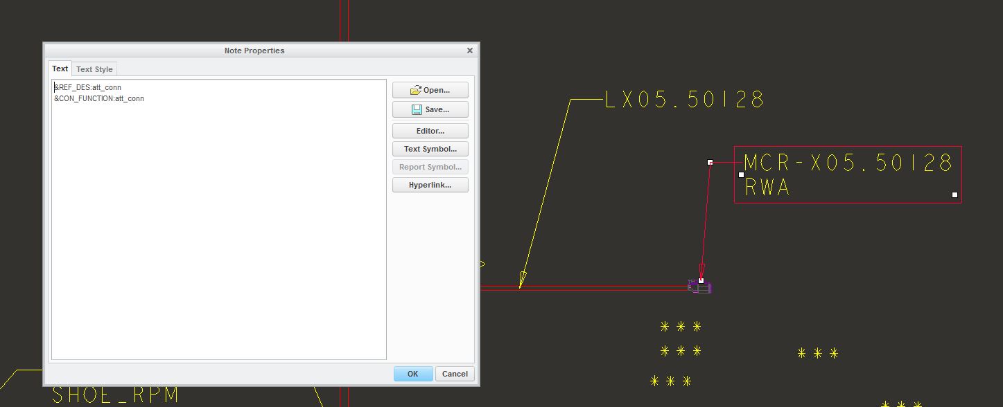

I had been facing situations to give the bundle lengths adjacent to each bundle for the harness manufacturing drawing. I could able to derive the details like designation of an attached connector, Name of an attached cable as parametric leader notes like following examples,
&REF_DES:att_conn
&NAME:att_cbl
Etc……
But I am trying very hard to find a way to arrive a parametric note for the respective bundle length separately. I am very well aware that it is possible through repeat region.
But this requirement would make easy for the manufacturer to refer the notes placing right near the bundles in the drawing views.
Kindly help me out to find a solution.
