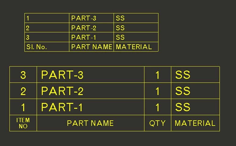

Hi.. In Bill of Materials i can rearrange the part names in forward or backward using sort regions option.. whereas i can't rearrange the serial numbers. Please help me on this regards.
  • June 17, 2016
  • 1024 views
Please find the image enclosed. I can rearrange the part name in backward or forward.. whereas i can't do it for serial nos. while creating BOM table manually using repeat regions. The same can be done using quick tables but i need how to create that manually.
June 17, 2016
first column contains rpt.index system parameter.
If you create table expanding downwards and define repeat region in it you will get:
1
2
3
If you create table expanding upwards and define repeat region in it you will get:
3
2
1
