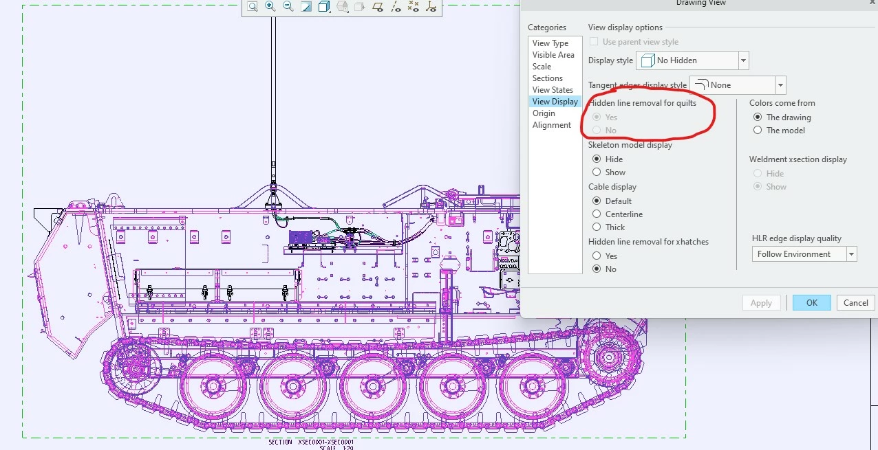

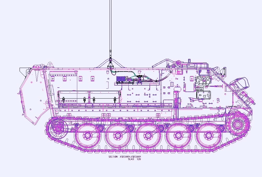

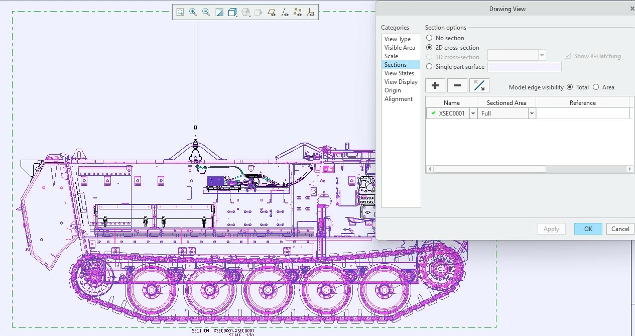

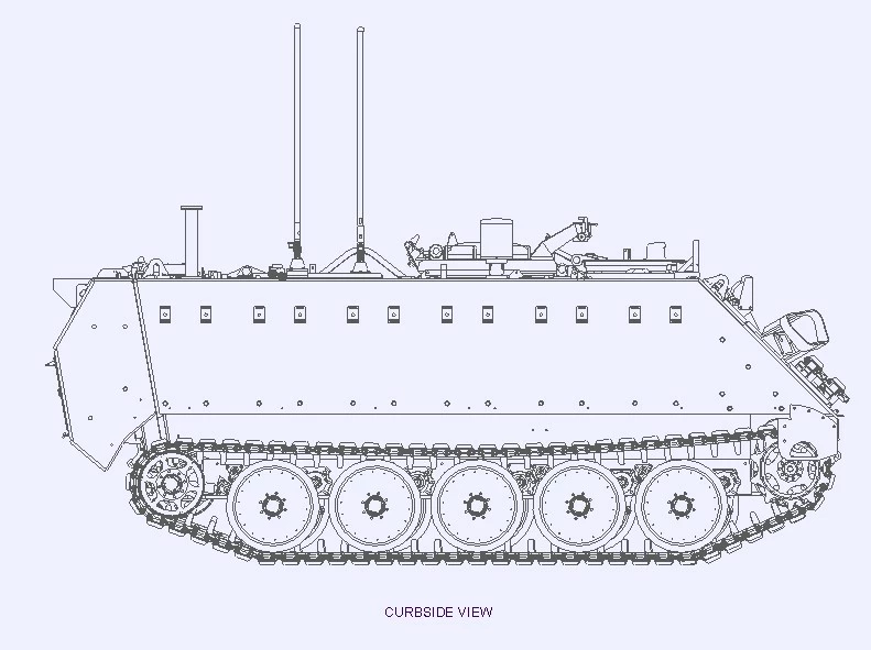

I want image 2,3,4 to be like image 1 that hides hidden line for quilts. If i select 2d section the option of hidden line is greyed out. It does not remove hidden lines. How to fix? Thanks in advance.

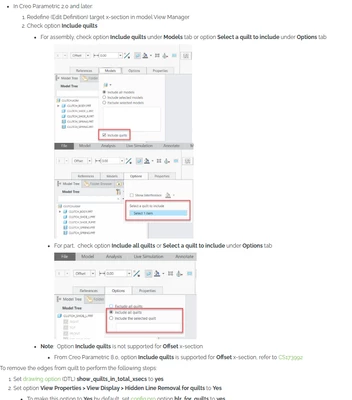

Maybe some of these links will help:
Cannot hide quilt - thread lines in cross section
How to enable view properties option "Hidden line removal for quilts" for cross section view containing surface parts in Creo Parametric
Cannot Hide Quilt Edges
(used this query in google search: hidden line removal for quilts in section views)

Yogesh doesn't understand that his images are illegible. He want to say that in the options of section definition you have to activate "Include all quilts”.
