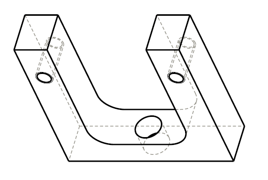

1) File --> Print. Select "MS Printer Manager", then OK and select your "PDF printer" in the "Name" field. Here is what I obtain with my "Adobe PDF" program :
As you can see, the dashed hidden lines are well displayed and are BEHIND the black solid lines that describe the shape of the object.

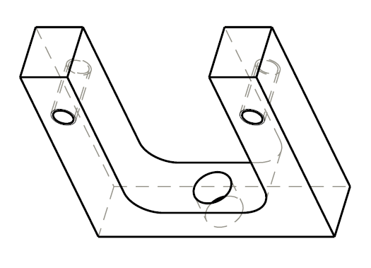

If you modify the plot_linestyle_scale parameter, the size of the hidden line changes. Here is what happens when I change the value from 3 (previous picture) to 1 (next picture).
Now the hidden lines appear with smaller elements.
With this method, all is ok .

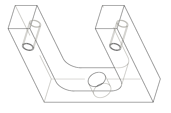

2) Click on the SaveAs PDF button in the toolbar :
Here is what I obtain :
As you can see, the dashed hidden lines have very long elements (they seem to be solid) and, if you look carefully, they appear IN FRONT of the black solid lines, in the same way as already described in the thread http://communities.ptc.com/message/158760. The black solid lines are also thinner than with method 1.
If you modify the value of "plot_linestyle_scale", there is NO modification.

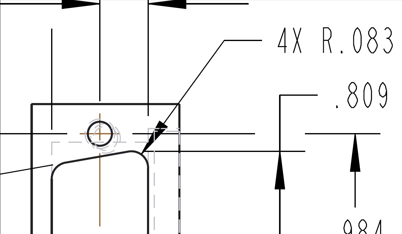

Has anyone figured out a solution to this problem, RE: I want to utilze the SAVE AS>PDF without the hidden lines obscuring visible solid lines and particularly call-outs or annotations (and avoid the printing with a PDF printer method)?
I am having the same issue the OP mentions however have not found a work around. Please see the image below. The call out arrow as well as the visidble geometry are clearly behind the hidden lines whereas they should be in front. Using a PDF printer resolves the issue however this method is cumbersome and time consuming. I have configured my pen table correctly and I don't believe that is an issue.
Thanks in advance for any help!!
May 7, 2014
If you used black for the hidden lines the error would go unnoticed.
This is most likely the 'fix' seen in the sequence above.
Probably it is due to PTC performing the HLR based on a front-to-back evaluation for hidden lines, so there is no fix on the user side.
PTC would have to gather all the hidden lines and plot them first or evaluate from back-to-front.
May 8, 2014
Thanks for the reply however internal drafting standards dictate that all hidden lines must be gray for reading clarification so this is not a viable option for me.
