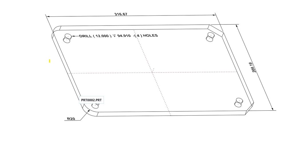

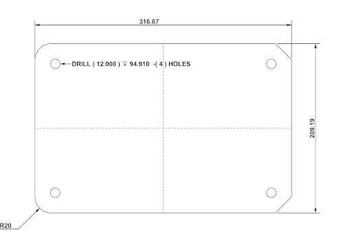

hole center mark not display after pvz export (MBD)
hole center mark not display after pvz export (MBD)After Export PVZ.pngAfter pvz axis display but Not Center mark.pngBefore PVZ export (MBD).png

In Creo Parametric, (not only the Hole feature) for any datum axis, when the axis is normal to the screen, user will be able to see it as mark lines (vertical and horizontal).
Unfortunately, those mark lines do not really exist, and it is special visual effect calculated & provided only in Creo Parametric.
In Creo View Client, such calculation & visual effect does not exist yet, and only the datum axis itself will be displayed.
Currently, it is not possible to export center marks for holes in the PVZ format.
