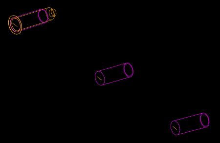

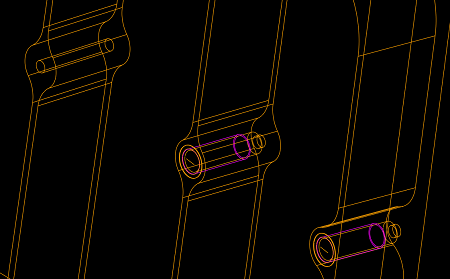

Anyone seen a case where placing a hole feature in a existing boss with a pilot hole deletes the entire part?
First image shows the first two holes placed with the third pilot hole and all of the surrounding part geometry.
Second image shows third hole placed deleting the entire part except the hole itself.
Patrick

Nope, that should not have happened. Did you try changing the accuracy fo the model?
pstapler1-VisitorAuthor
November 22, 2014
Yes. We are required to model at Absolute .0005. However, I tried A.001, A.002, A.003, A.005, and R.001. All yield the same results. Oddly it isnt just that location. This part has hundreds of these bosses. The hole feature will go into most of the bosses I have tried without deleting the entire part. It only occurs in certain bosses. However, they are in random locations throughout the part.

What I have noticed is if I place the hole all the way through the part it doesnt have the same affect. Additionally, if I place a extruded cut in those same locations to a specified depth it still deletes the part. However, if I place the cut through all it does not delete the part.
November 22, 2014
I have seen this on occasion. It shouldn't happen, but it usually has to do with the dimensions of the new feature and proximity to edges or vertexes in the part. Nothing jumps out in your screen shots, but I'd try tweaking the dims of the feature to see when it causes the trouble, that can lead you to a solution.
I'd also look for other geom checks in the part. My experience is that a geom check that seems to regen how you want still means that Creo is guessing about what should happen and happens to be guessing right. It can lead to odd results like this later down the tree sometimes. Resolve those and you may clear this up.

November 24, 2014
2.0 M120
No other geom checks in model.
Turns out it is related to (or at least it goes away) the formed state of the part (Flatten-Quilt). The hole can be placed in the flat state with no problem. However, it seems it would be a problem with all of the holes in the rolled state rather than a select few locations if it is truly related to the Flatten Quilt feature. The pilot holes are drilled on the flat part. The part is then rolled. Then the tapped holes are modeled. So basically how the part is actually built.
So...still confused.
