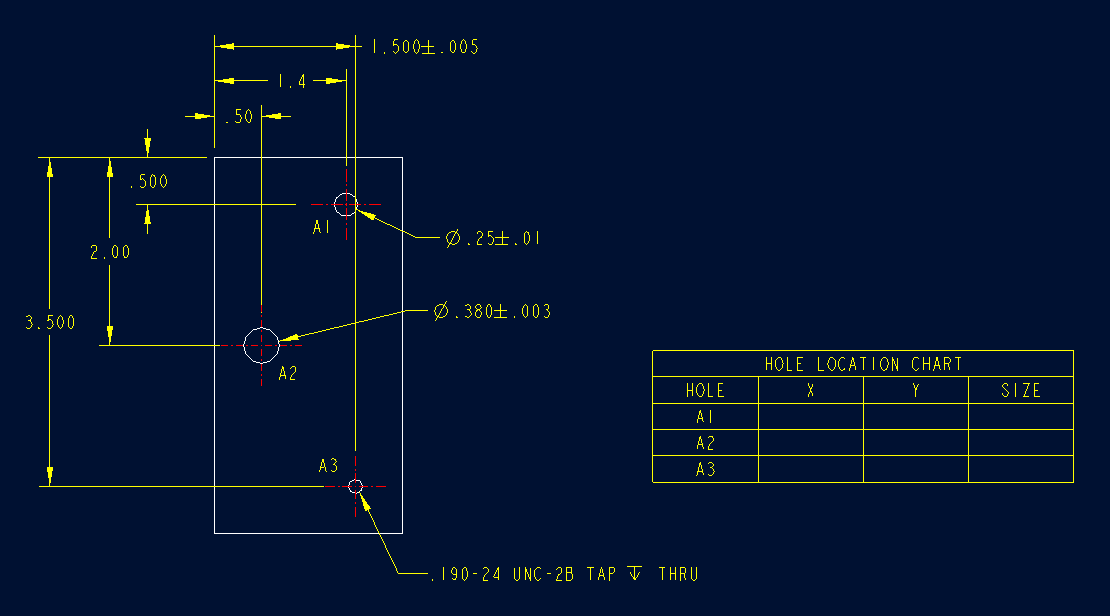

shown with WF4
Holes were placed with existing tables and were assigned tolerances.
Dimensions were also adjusted and toleranced accordingly.
This information is carried into the tables as such:

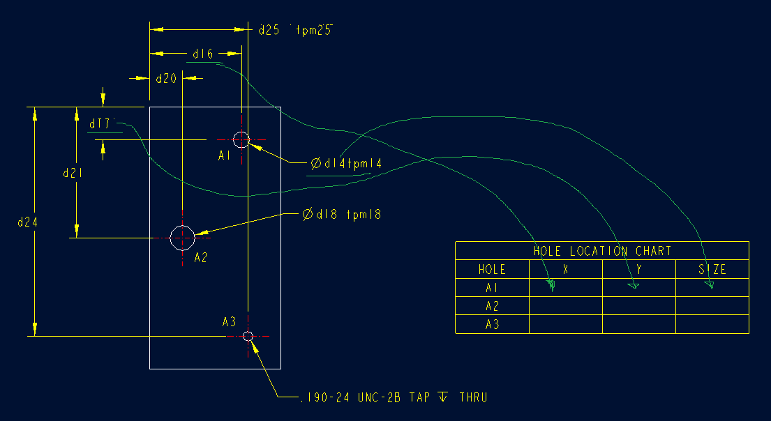

then switch your dimensions (info > switch dims)

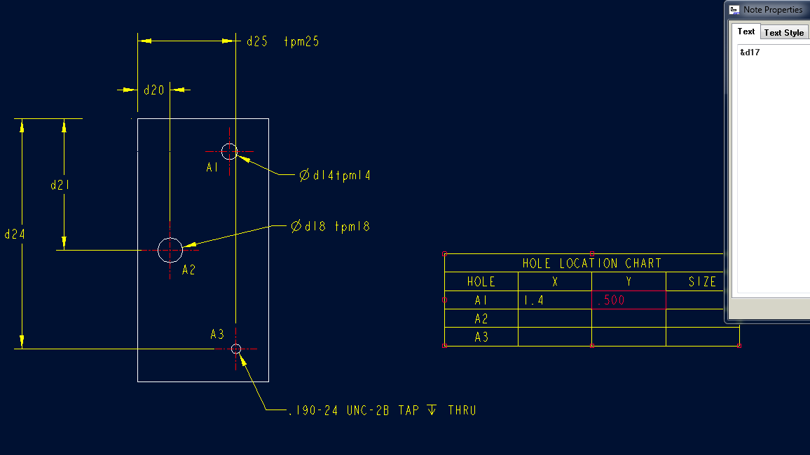

Put these values (only "&d<value>") in your chart, like so:

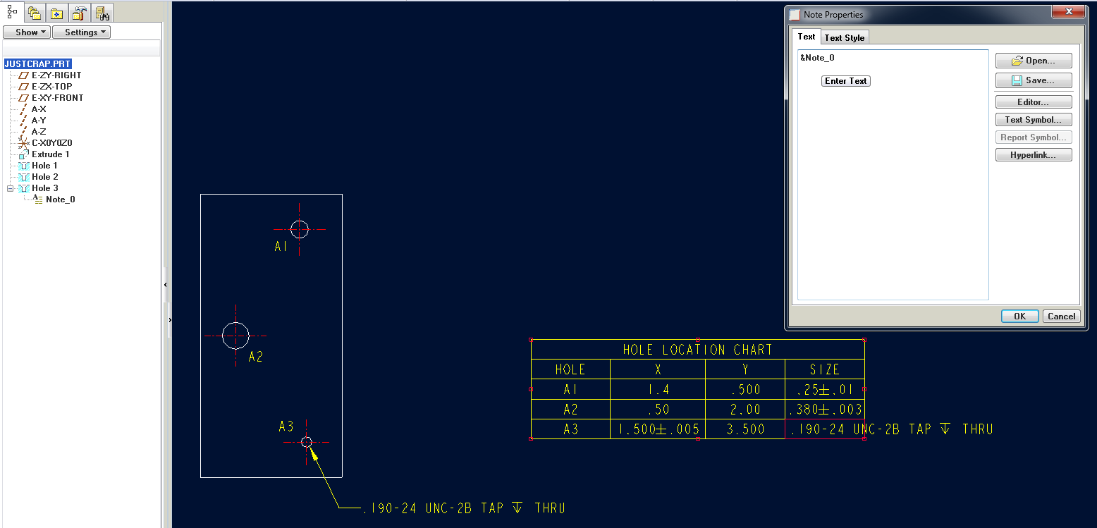

notes are a bit different, but not too much, get the name from your model tree
I think that answers your question.

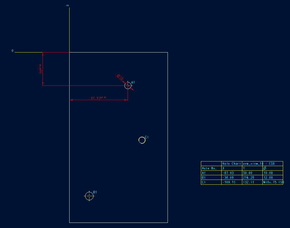

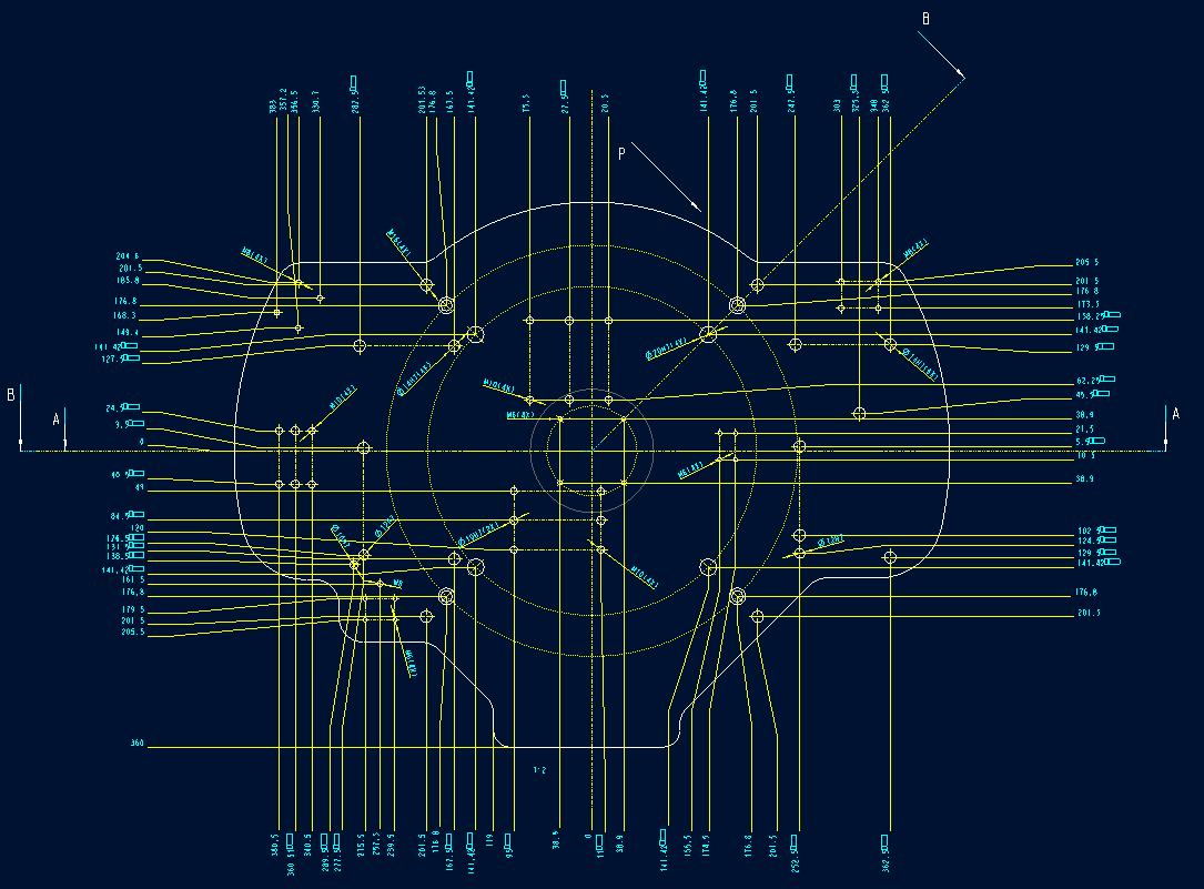

I think I did not explain the problem exactly (I am sorry for my english) but I am just trying to find some easier way to make drawings that include many holes - it just takes long time and so on.
Here is one example:
so far i was just dimensioning all holes by coordinates. Now i noticed there exists a functionality called "hole table". The table is very easy and fast to make but there are two things i would need to add in it: a hole tolerance and a hole position tolerance.
