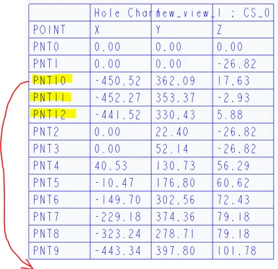

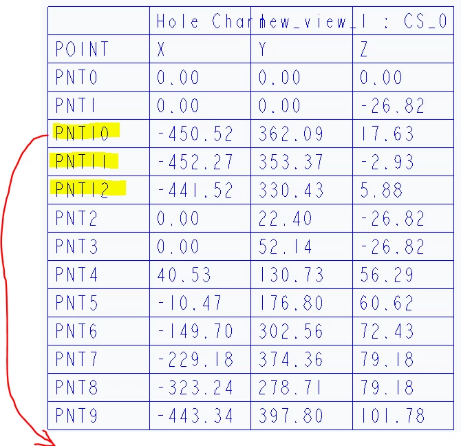

Hole table through datum points need help on how to sort feature name column in re. order (Creo 10).
I am creating a hole table through datum points like feature name "POINT" & its "X,Y,Z" measurement through cs_o but when datum points go beyond 9  for e.g. "PNT9" then it sort by again first digit means it will go like 1 then 10,11,2,3,4 likewise (refer snap for more details).
I have tried to increase decimal point from 1 but it won't get sort out.
Need help to how to sort this double digit figures in ascending order & Is there any way to make this hole table parametric if point location is updating it will directly show on table without adding it again.

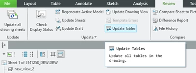

1) workaround is to rename your points to have a leading 0:
PNT00
PNT01
PNT02
PNT10
PNT11
in part modelling mode, go to the menu: File -> Prepare -> Model Properties -> change Names:
2) update your hole tables in drawing mode with the "Update Tables" function:

July 15, 2024
The system is functioning correctly! It is sorting all PNT1* values first, then it will do all PNT2* values.
The solution is to use the same number of digits in all of your values, PNT01, PNT02, etc.
