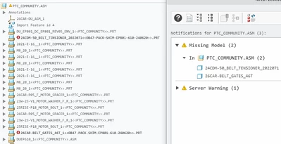

How can embedded components in an inseparable assembly be missing?
Creo tells me that embedded components in an inseparable assembly are missing:
How is this possible? My understanding is that those components are saved in the assembly file-how can they be missing?
Hugo-KTMAnswer
I think I figured it out:
I was able to create this issue if I save the assembly while the embedded component is not "loaded".
You can erase embedded components from the session and if you save the assembly the embedded component disappears.
Simplified representations allow you to exclude components, and then you can call Erase Not Displayed to remove those excluded components from session. If you save the assembly in this situation, the embedded components are deleted.

The missing components look to be instances within a family table.
Do others have access to this family table.
Could the instances have been renamed / deleted?
Hugo-KTM14-AlexandriteAuthor
Why do you think that? Is it the "<<..>>"?
The whole assembly is an overlap of two imports.
I tried to rename the assembly, and learned that embedded components cannot be renamed (via renaming the assembly) and for missing embedded components not even the reference to the original assembly name is changed.

The whole assembly only contains imports. I did not find any indication that there are any family tables involved.
Hugo-KTM14-AlexandriteAuthorAnswer

We are experiencing a very similar issue in Creo Parametric 13.4.1.0.
Four suppressed embedded components have become permanently unretrievable. The issue is reproducible across multiple computers, users and Windchill workspaces, including offline mode.
We also identified an infinite Notification Center loop triggered by the retrieval failure.
You mentioned that this issue appeared to have been fixed. Could you confirm the Creo version/datecode containing the fix, or provide the associated SPR number?

I just noted that this issue is not fixed.
I think that I had a specific scenario in mind when I tested this and that specific scenario is prevented now, but the underlying problem is still there and you still can destroy you data with inseparable assemblies.
