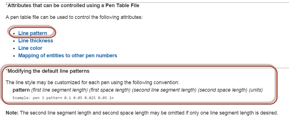

Mahesh_Sharma
22-Sapphire I
September 4, 2015
Mike,
Yes, pen table will control thickness, this can use to control line pattern as well.
From http://support.ptc.com/cs/cs_24/howto/plt522/plt522.htm#pattern
