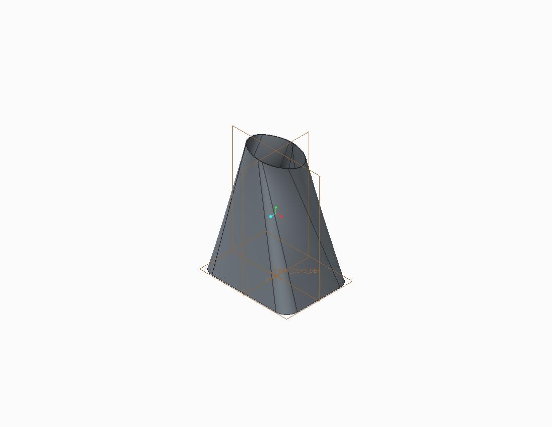

HOW CAN I CREATE UNBEND SQUARE TO ELLIPSE BLEND OF THE HOPPER TYPE OF SHEETMETAL PART??
  • January 4, 2017
  • 9 replies
  • 3602 views
HOW CAN I CREATE UNBEND SQUARE TO ELLIPSE BLEND OF THE HOPPER TYPE OF SHEETMETAL PART. I TRY USING SKETCHED RIP AND EXTRUDE CUT THEN UNBEND BUT COULD NOT SUCCEEDED.I THINK UNBENDING DIFFICULT HOPPER TYPE SHAPE IN CREO SHEET METAL IS NOT POSSIBLE. THIS IS A MAJOR DRAWBACK OF CREO SHEETMETAL.
PLEASE ANSWER THIS QUESTION. I HAVE A DIRE NEED.

Post a screenshot or some other information with the part you are working with. A hopper can be anything. If you are designing hoppers to made with a simple press brake, it must be done with specific techniques. If you are using a forming die, you will need to use other techniques.
I have made many hopper shapes, some build for simple press brake construction, some welded, some formed with a die.

this is the image of the part. I don't know how to attach creo professional edition part file in.prt format in the post in ptc community. Please guide me. I am uploading jpeg image format. I am trying to unbend it but cannot succeed.sheetmetalblend.jpg
January 5, 2017
That part does not appear un-bendable.  It looks like the surfaces are all complex-compound curved surfaces.
To be able to unbend geometry it must consist of ruled surfaces.
Ruled surface - Wikipedia
If that is not the case - then the other issue, most likely, is that you don't have an open seam.

I request other creo users to create ant try to unbend a square to ellipse blend in creo sheetmetal. If you get any solution please reply in this post. with creo planar, extrude, flat and flange option a part sheetmetal can be unbendable but when you use sweep or blend the sheetmetal part is unbendable.What do you think?

The surface you are trying to create is not a candidate to be un-bent.
Similar to how you cannot un-bend a dome because it has compound curvature, your shape also has compound curvature
However, perhaps you can create a punch/die feature to create this feature.
But as-is, it is not unbendable and there is no realistic "flattening" of that type of surface.
