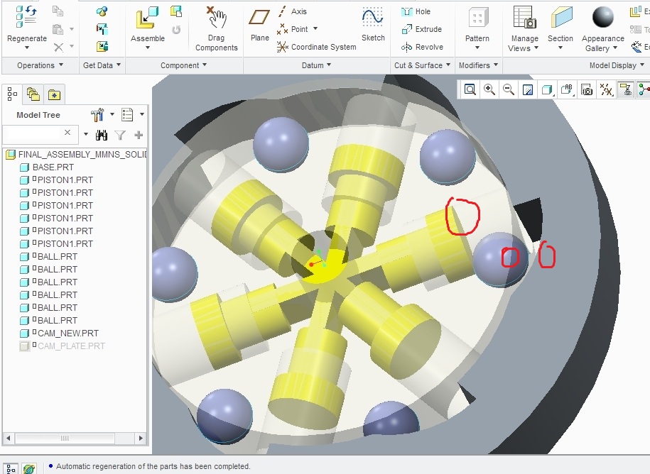

The problem is how to assemble the piston, the ball and the circular CAM ring ?
The working seems so simple : u rotate the CAM ring anti-CW to a degree, it pushes the ball and the ball pushes the plunger/piston...punching done...
Can someone help me out?

    We often add features to make sure we have things we can contrain.
    In the case of the sphere and piston, tangency and axis; in the case of the cam, tangency or follow a curve path.
    If you want to share the model, we might be able to come up with something slicker.

    Sir,
    I have added the files.Please correct them if you can and re-attach them again so i could see where i was wrong.
