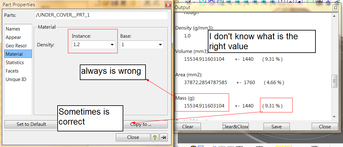

How can I offer desinty to measure weight in creo elements direct ?
  • October 23, 2015
  • 2 replies
  • 1581 views
I don't know what the value is right ?
I use part properties , like picture
please tell me what the value is correct ?
Thank you very much
October 23, 2015
If you use the part properties values for volume, area, mass, ... may have tolerances like in the picture.
This depends on the complexity of the model.
If the model only includes regular geometry like plane, cylindrical and conical faces the tolerance should be 0.
But if the model has spline faces included then it may be harder to calculate the values.
In this case you have the possibility to set a maximum tolerance like 1%.
This is in the menu in Statistics. There you can choose between rough, 1, 2, 5%
If you use 1% you will see, that the results are much better.
