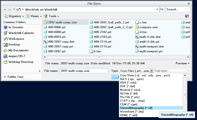

January 18, 2016
try the .stl
go to file > open > open existing file
use the pull down for the extention
February 17, 2016
If you export it as txt and it keeps all the points in an x y z columns, then you can open the .txt file in notepad and save as a .pts file. Then you can use the get data option to pull in the points with the .pts. If its not in xyz columns youll have to manipulate it in xls first and save it as a tab delineated .txt file then save as a .pts.
