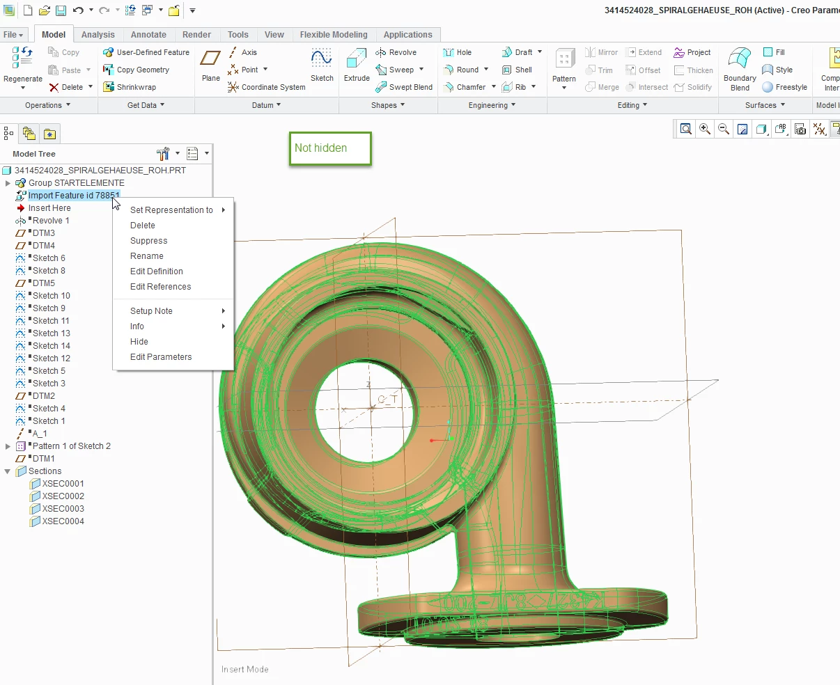

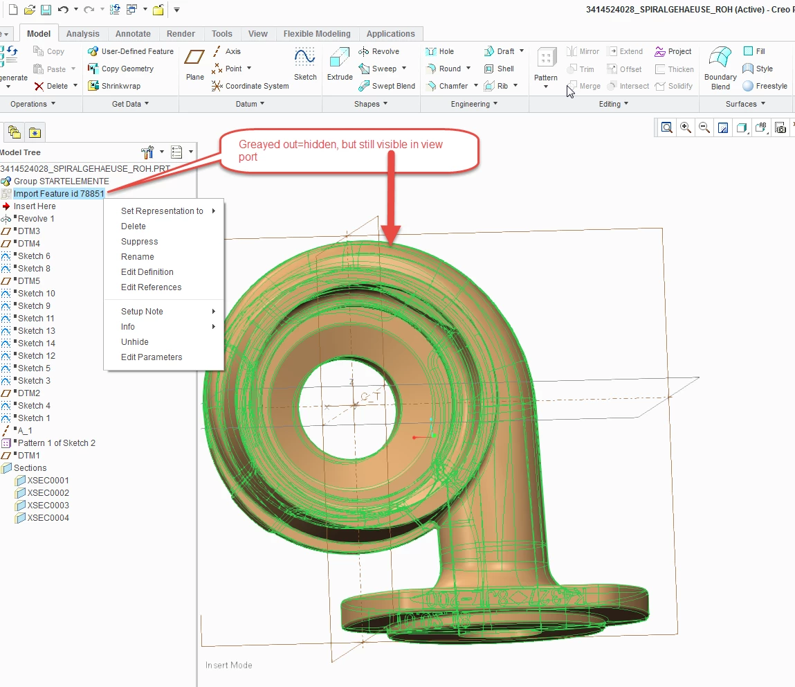

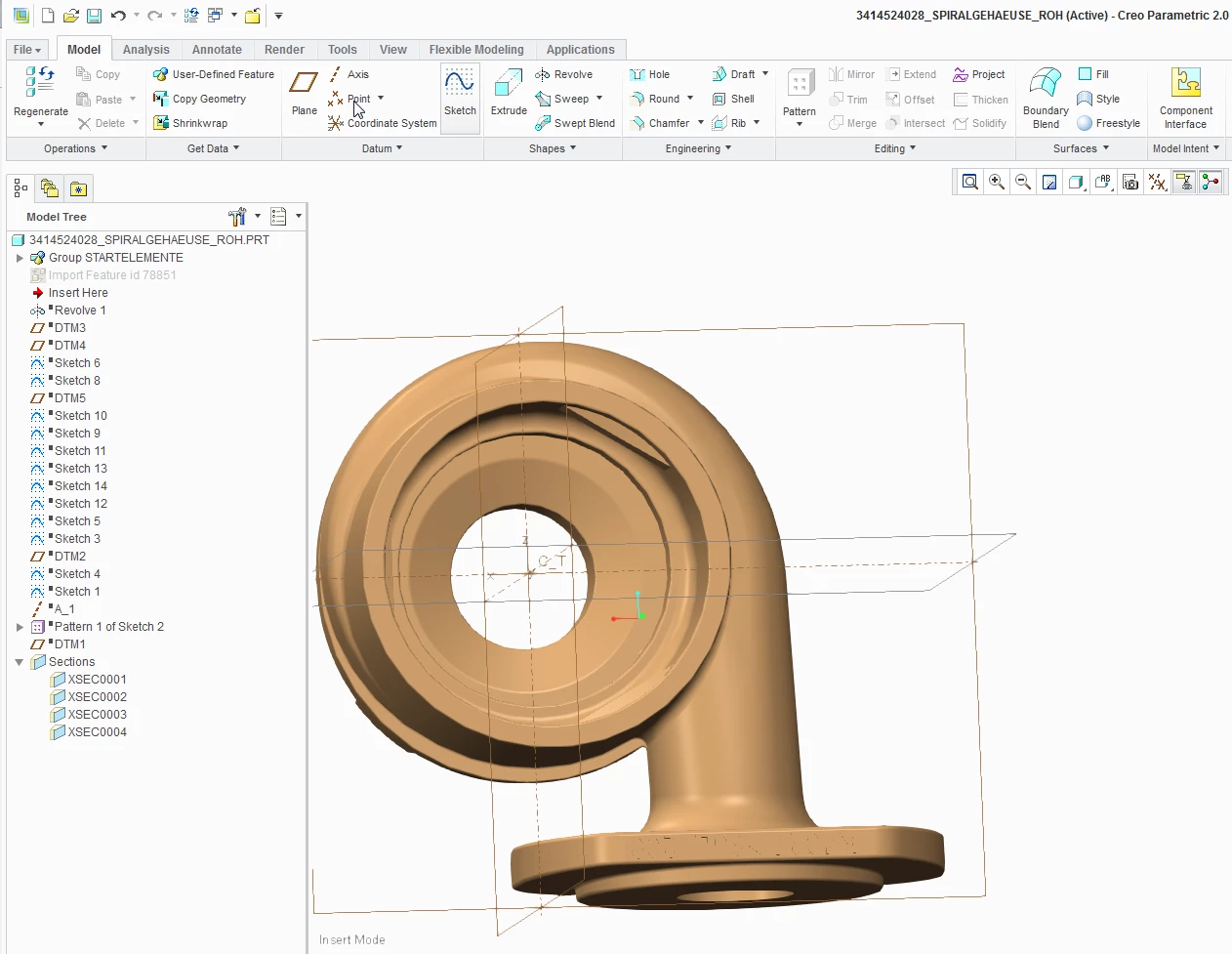

February 28, 2017
Creo doesn't like hiding primary solid geometry.
However, if you have additional solid features, you can move the import feature in the tree to hide it.

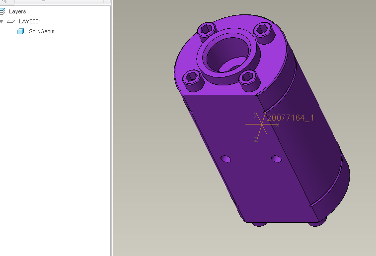

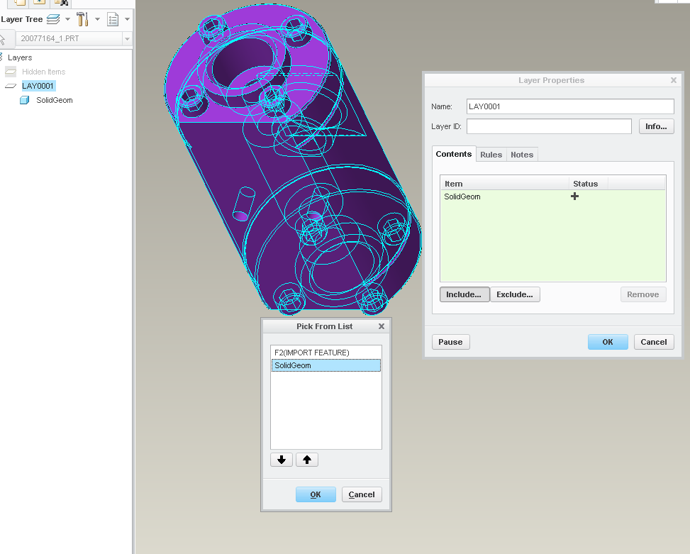

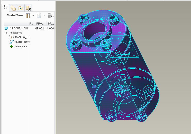

February 28, 2017
I'm not sure what you are doing but it works great for me by specifically adding solidgeom (not the import feature, that will not hide solid geometry) to a layer and then hiding that layer.
StephenW
February 28, 2017
Make a layer. Add SOLIDGEOM to that layer, not  the import feature. You'll have to use query select (or RMB pick from list to get to SOLIDGEOM. Then hide that layer.
