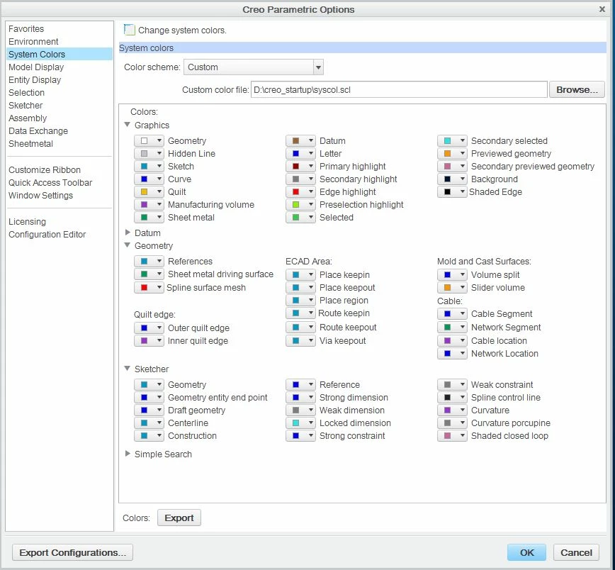

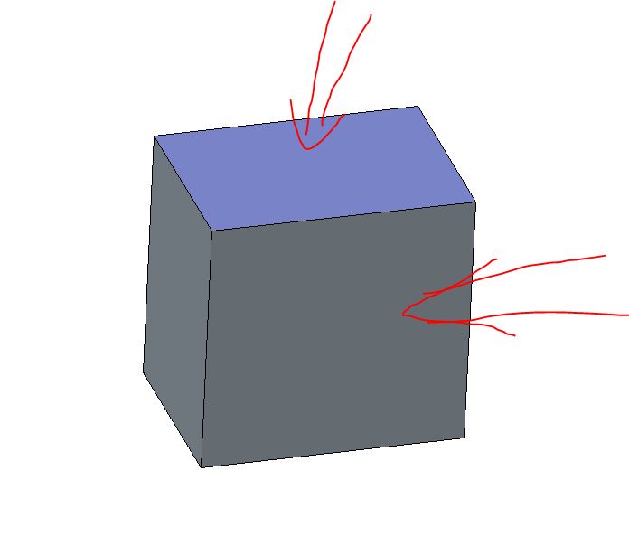

How can I set the surface and solid colors in Creo2.0 as the below pic.?
Which icons can control these two color in the system colors setting options?
December 30, 2015
there are no icons driving these colors. You have to change default appearances.
