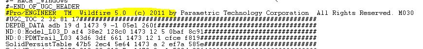

I am needing to fine out which version of ProE was used to create a file, be it a Part model, and assembly, or a drawing. Can you tell me how to find this out?

Best answer by egifford
Gerald,
You can usually open the file in a text editor and the header portion will list the version of the sofware used to create the file. It will look something like this:
Erik

April 12, 2011
Gerald,
Erik

April 13, 2011
Thanks Eric. This helps me. Have a great day!
