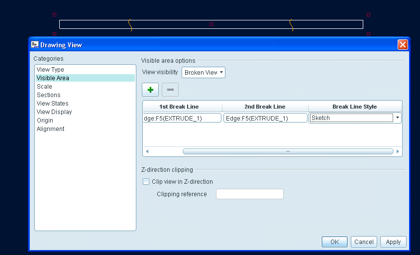

Hi,I am trying to produce a 2D drawing of assembled hydraulic cylinder but the problem is, it's too long and I am having difficulties to view the sectioned parts in detail. Is there anyway to cut the middle section so that I will be able to zoom in on end parts?
regards
Best answer by KshetrabasiMaha
Hi
I think you want to show the end portions of a long part by removing the middle portion.
This option is in broken view
Seethe pictures below
(If your requirement is something else then please post with a image for better clarity)
Regards

akhadka1-VisitorAuthor
May 15, 2012
Hi kshetrabasi mahanta thank you! this worked for me
