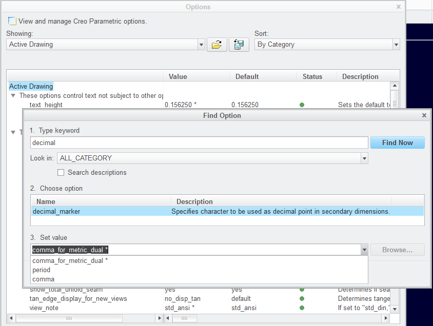

I know there is a setting for making metric (SI) dims with commas, but I am not sure that is the case with equations in relations or even parameters.
Look for decimal_marker in drawing .dtl settings, not config.pro (model options).

I'll give that a try. I wonder, when using the ANSI format, the tag to limit the decimal places is [.x]. I wonder what the ISO equivalent of that tag is, and if that might produce the desired result.
March 17, 2014
It should be the same. Let us know what you come up with.
