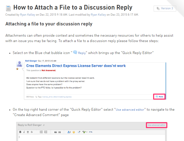

'AT6105-9015-03 cannot be retrieved' message tells you that ProE does not understand the contents of the file.
You can upload it using How to Attach a File to a Discussion Reply procedure.

But why the link you send is like this?
After click:
September 8, 2016
His link is telling you how to do the upload.  It does not actually do it for you.
