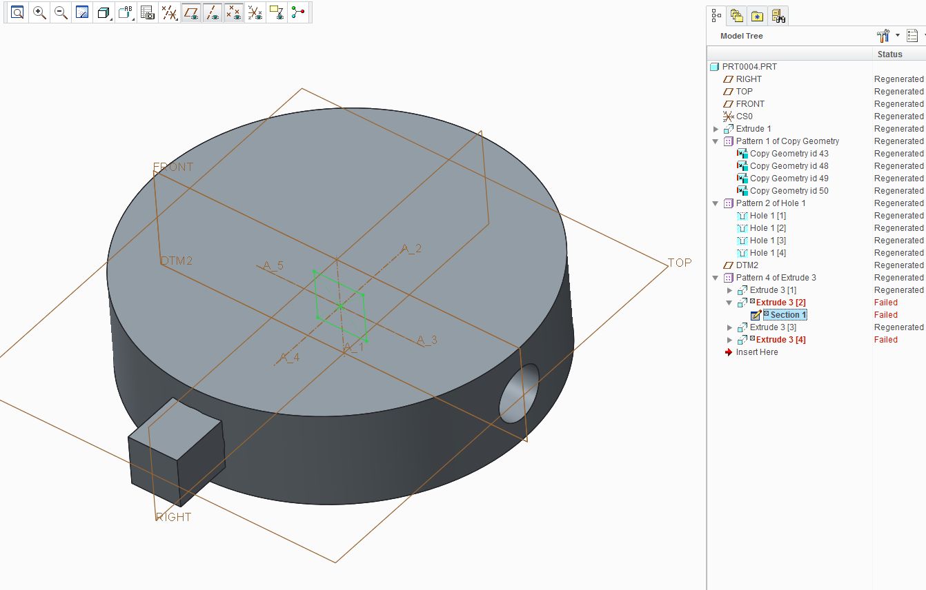

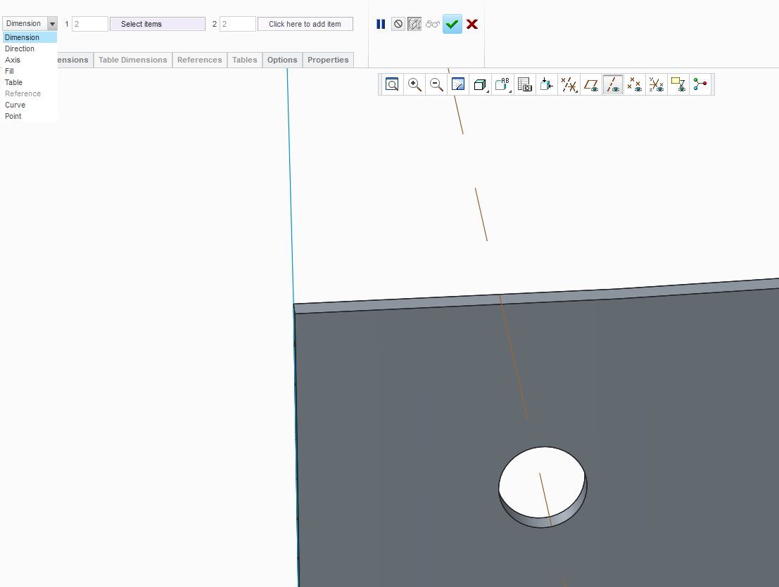

bp_011-VisitorAuthor
June 18, 2014
One last question, I still cant create extrudes with reference-pattern (using an axis and a new plane as reference, the axis comes from a circular pattern in a skeleton), only holes. I dont get it, is this a bug?
Also if I create a reference pattern of a new axis using the skeleton axis as reference and then reference pattern a hole on the new axis pattern, i get an error
June 19, 2014
Stop looking for a solution everybody, I just figured it out.
In order to succesfully reference pattern an extrude feature on a circular pattern, you need to include the sketchplane in the pattern by grouping this plane with the extrude and then patterning this group. (otherwise the pattern members of the extrude cant find their sketchplanes )
