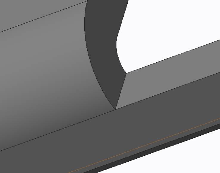

I received an STP model of a part.  The part is a sheet metal part.  I had made some modifications to the part where I cut out a section that comes off a bend, makes a 90° turn and blends into a flat. Essentially, the part in flat had a Round and then the area of the round was bent 90°, causing the Round to stretch.  I would like to recreate this stretched Round in the corner that I made.

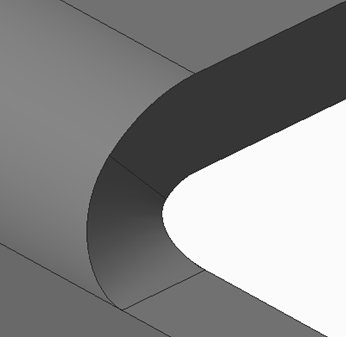

The original bend was similar to the following:

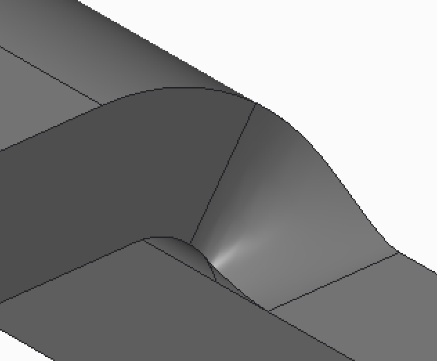

After I modified the part I was left with a corner:
When I try to insert a Round, I only get the following:
I couldn’t figure out a way to make the Round follow the bend.

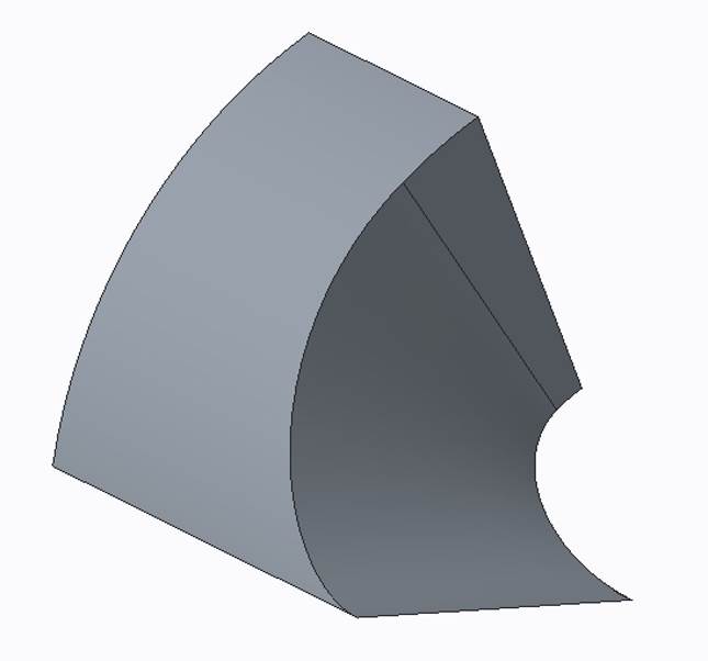

As a temporary fix, I made the corner in PTC Sheetmetal:
And I then merged it into the part as an assembly:
But now I must have this corner bend follow the part.  If the two get separated, the part model fails.
I would like to be able to create the curved Round in the model instead of merging in another part.

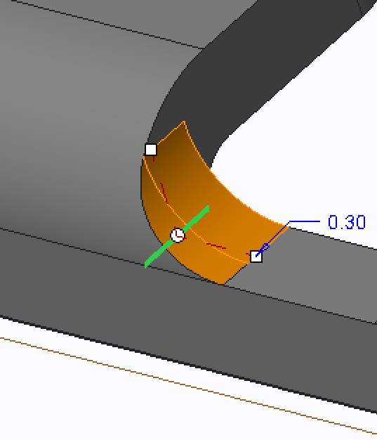

Did you try with boundary blend in part mode?

Being new to Creo, I haven't used surfaces in many years.  It took me a few hours, but I figured it out and now I can create these features in a few minutes.  Thank you for your suggestion.

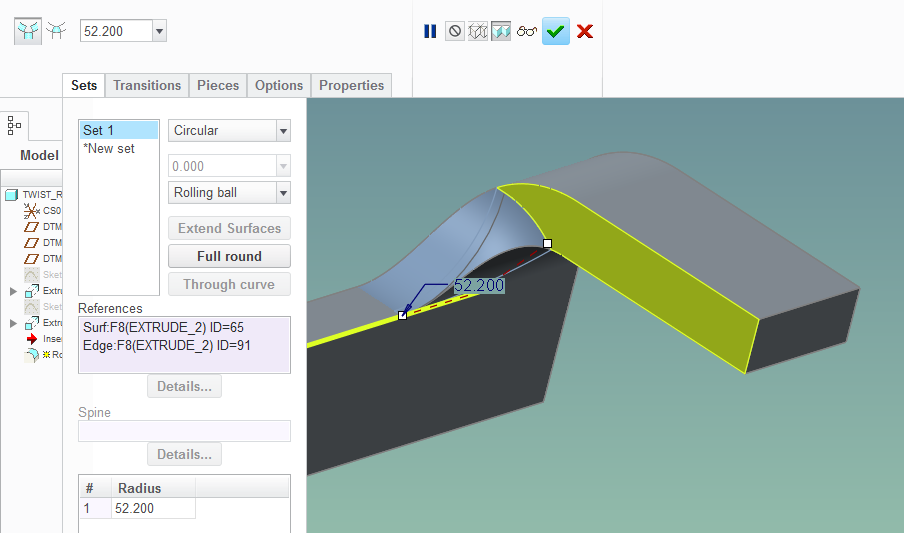

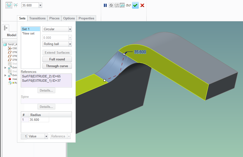

In Creo 2.0, you can make this kind of transition using the round tool:
September 28, 2016

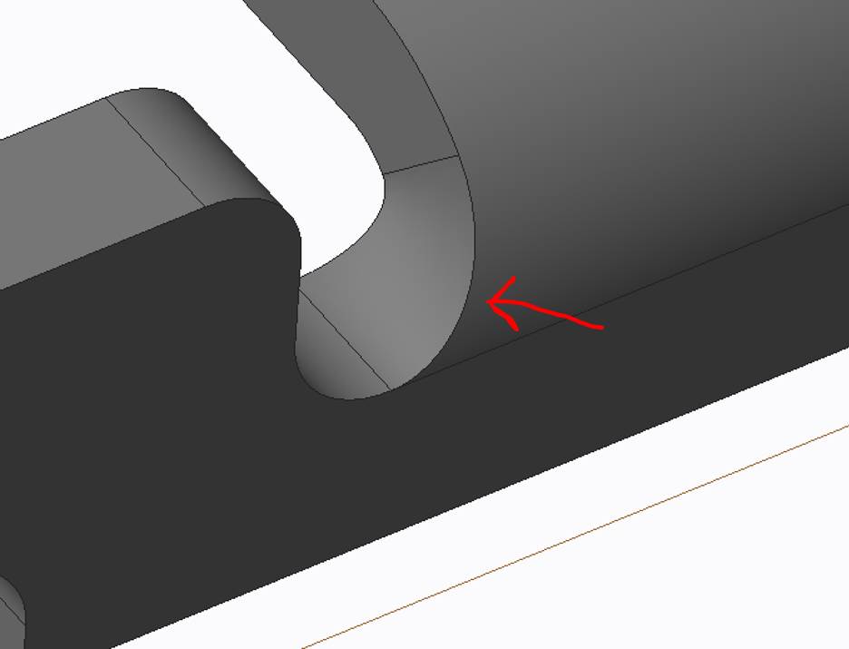

Selecting the adjacent faces also produces this transition:
I know that's not really a "twisted" surface, but do you really need that sheetmetal-twist?  I don't think it's fully realistic either way...
