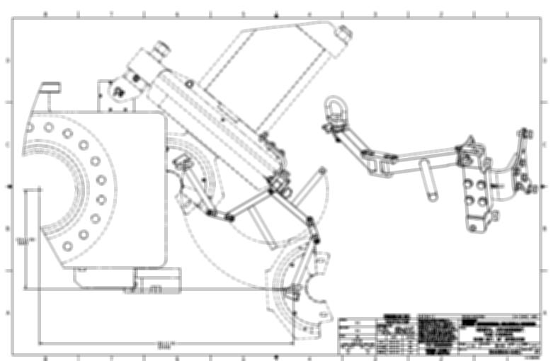

Drawings are the typical method of sharing information within 3d models. This one was done in Creo Parametric not Elements direct.
I'm sure that elements/direct has a drawing/drafting function but I am not familiar with the software.
Image below is a drawing of a tool we provide.

You will need to use the Annotator (Annotation) module in Creo Elements/Direct Modeling to create 2D views of parts/assemblies. You can create Isometric views and then simplify the contents of the views by removing hidden lines, tangential lines, etc.. from the view.
