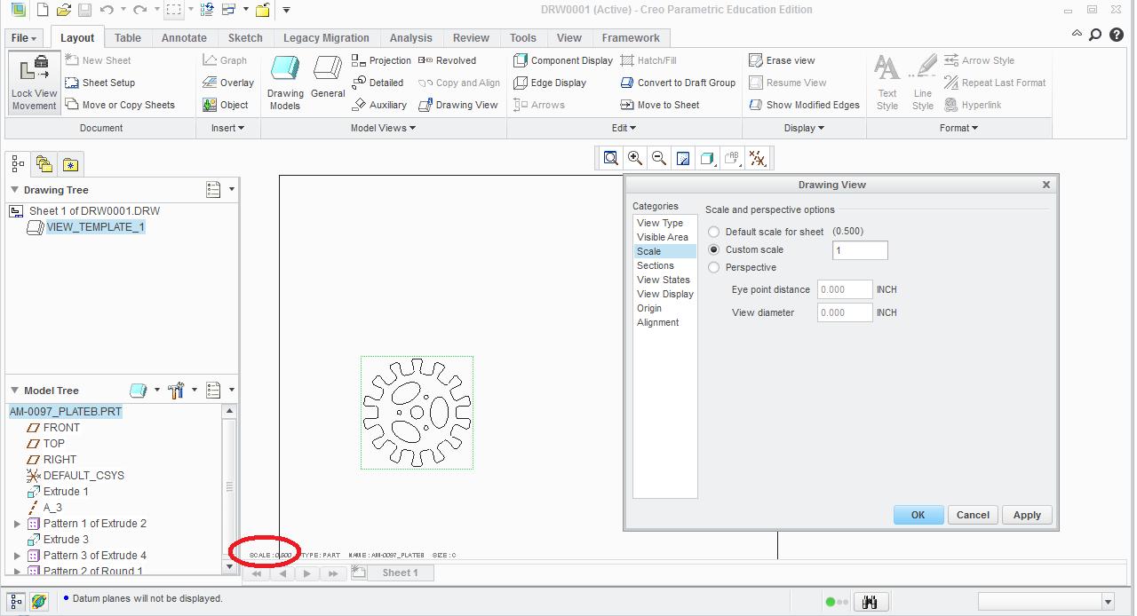

I'm designing some parts for a robotic arm for my students to make.
When I convert the part to a drawing to convert to DXF, The scale of some of the drawings come out as 2:1 others come out as 1:1.
When I export them into other software to cut them out on a Roland engraver, some come out twice the size.
How do I change the scale of the Drawings from 2:1 to 1:1?

Two ways:
One in drawings doble clic the view/ category scale/ change the custom scale to 1.
Two, you can doble clicl on the little text on the lower left part of the sheet that say scale,/ input 1 and enter.
This snapshot is in creo but that haven´t changed:
ptc-44790101-VisitorAuthorAnswer
