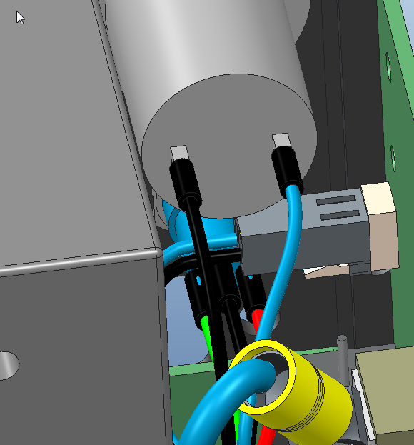

In the marketing page for Creo Piping and Cabling Extension, http://www.ptc.com/File%20Library/Product%20Families/Creo/Model/PTC_Creo_Piping_Cabling_Extension_DS.pdf on page 4 there is mention of 'realistic shrink-wrap tubing"
Is this only showing where multiple bundles come together? Although required, this falls short of depicting a majority of the "shrink tubing" uses in manufacturing today.
Are there any methods, to show the application of shrink tubing over multiple components ( cable connector, cable, bolt, washer, nut)?
Thank you for your help.

Allen,
Similar to these over solder posts or hooks?  I haven't seen the ability to change the overall width to a thickness.  That would really be realistic. I have seen shrinkable boots that mimic formed shrinkwrap but that would be its own part.
jef

Hi there, so it is only, cylindrical representations.
I am fine with another part. So far though, it takes several copy geoms and stitching of surfaces.
