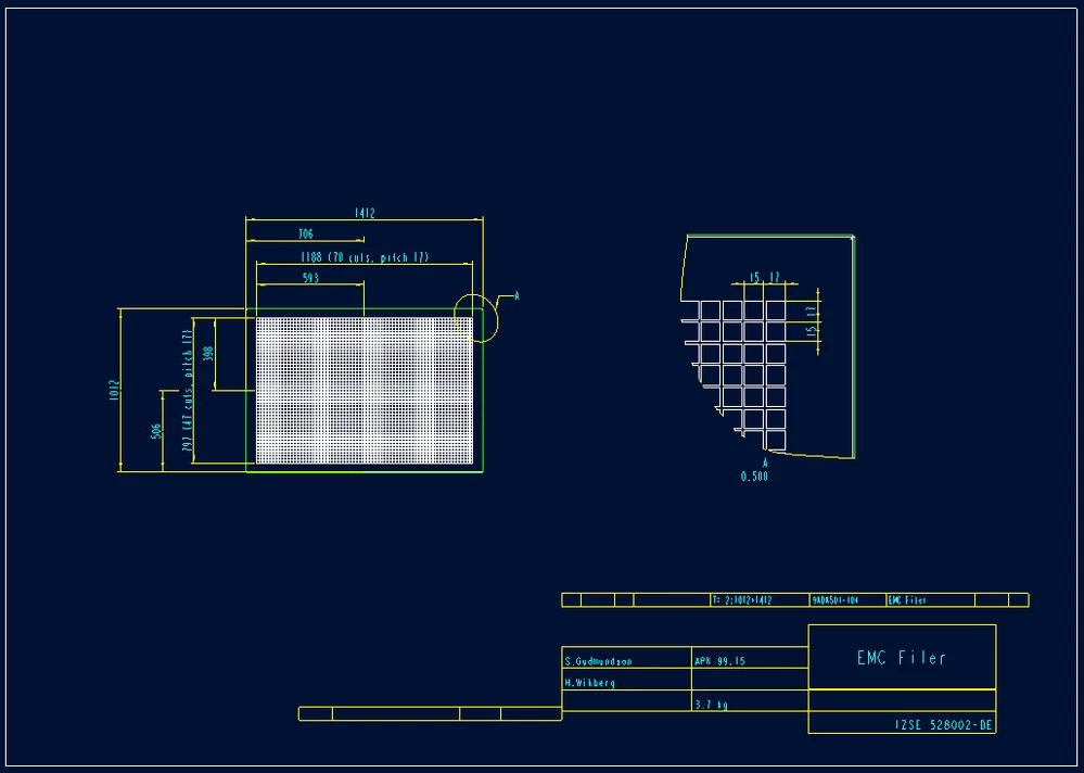

I have been sent a number of DRW files and am trying to view their content. Is there any viewing software package that will allow me to do this? I have downloaded a Trial version of CREO 4 and it will not open them. Is there something I need to do or have installed for this software to actually work? a sample file is attached if that will help

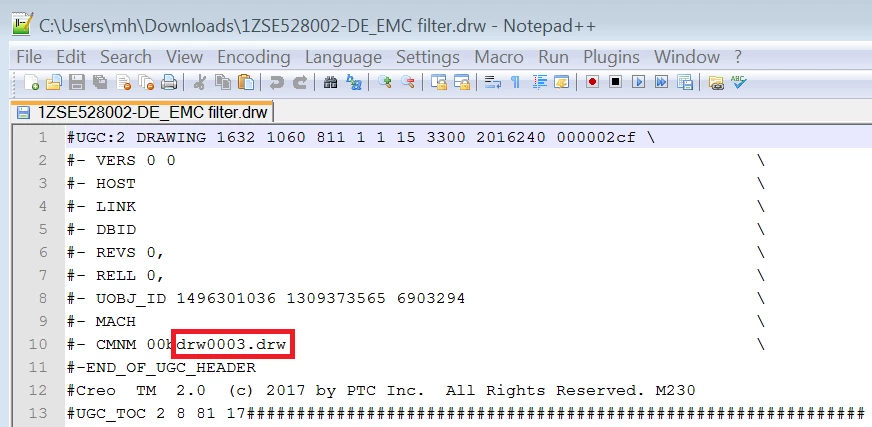

1ZSE528002-DE_EMC filter.drw is invalid name - somebody rename the file outside of Creo. If you open the file in Notepad++ you can see this:
2.)
I renamed 1ZSE528002-DE_EMC filter.drw to drw0003.drw

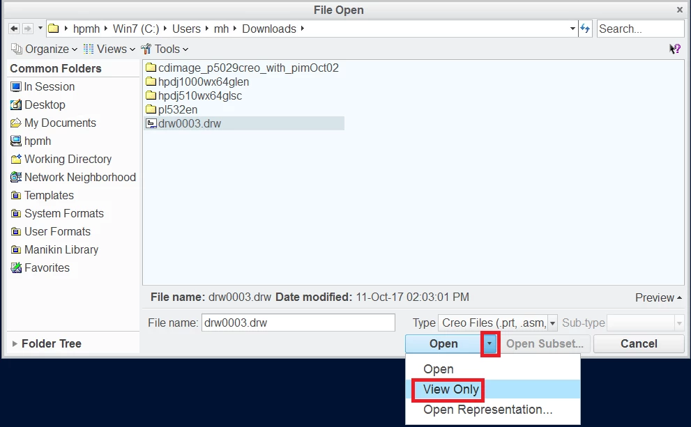

File > Open > click arrow on Open button and change it to View Only
You will see this result.
Over 20 years using this software, I didn't know this option existed!  How long has this been possible?

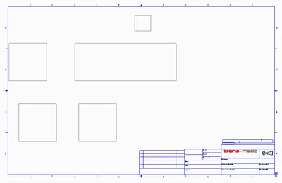

When I try this the format is still getting loaded and I don't see anything in the drawing views.  Not sure how useful this is...
Edit:  Apparently "save_display" has to be set to "yes" for this to work.  Read all about it here: http://support.ptc.com/help/creo/creo_pma/usascii/#page/detail%2FAbout_View-Only_Mode.html%23
