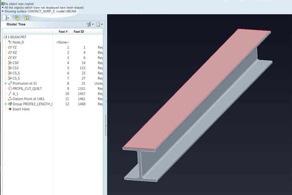

Not a datum plane, but one surface of an extrude?
lococnc1-VisitorAuthor
July 22, 2010

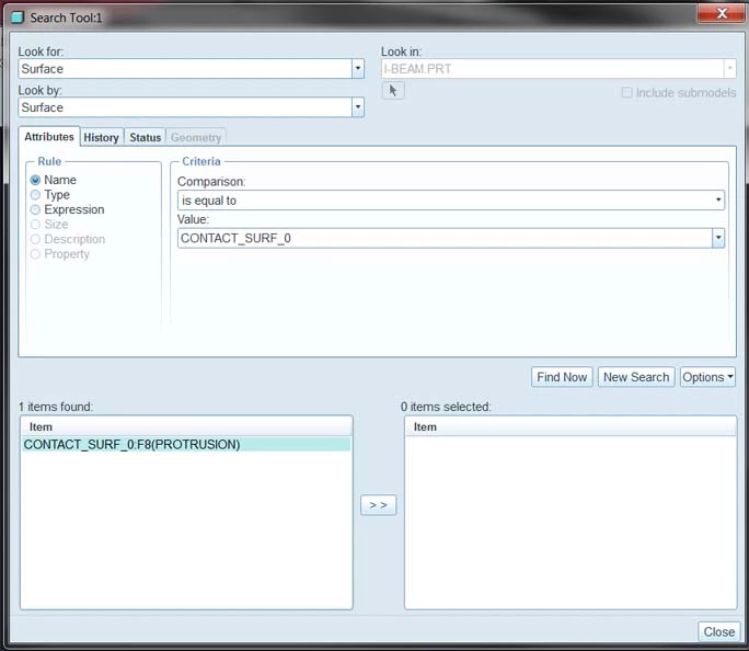

I am getting a lot of replies saying it can't be done. Please see attached image. Notice that I have selected a surface and it shows the "name" of the surface as something someone has set to, not the default ID.
How?

OK, so this proves I am not nuts...
