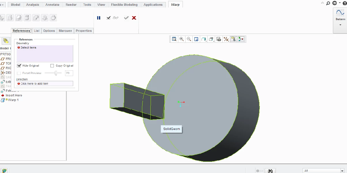

I have two shapes (a cylinder and a cuboid) attached to each other and I just want to warp the cuboid protruding out into a twist.
However, when I select the warp tool and I select which shape I want to warp (under references > geometry) , both shapes are highlighted and there is no way of just selecting the cuboid by itself. I've attached a photo to show the two shapes highlighted.
So, how do I warp a shape without affecting other dimensions of the other shapes (e.g. the cylinder)?
The only way I can think to do it is to warp the cubiod first, then attach tge cylinder, however I have already done a lot of work on my cylindrical shape and do not want to restart my project.
Thank you.

You alternative is the best bet but you do have an option within the warp feature. Just move the marquee (the frame) to be above the cylindrical feature.
Back to the optimal method however; If you isolate the cuboid you can move its features before the cylinder features and move the "insert here" to just above the cylinder features. Now you can warp the cuboid and if the cylinder features are not related, they should regenerate just fine when you resume them.
It is very common practice to re-arrange features in the tree, and to be mindful as what is related to what. In the long-run, it all aides in making a model sustainable.

I'm having trouble moving the marquee during warping. Can you explain how to do that?
