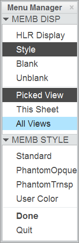

in Drawing mode activate Layout tab and use Component Display command in Edit group to set Style of component display.

I should specify, my drawing will be of shaded parts (as they appear in the model) and not of a wireframe with lines. So component display does not seem to affect the shaded views, or at least I have not been able to figure out how to.

I also tried Component Display (Layout tab). Picking PhantomOpaque or PhantomTransparent does nothing to shaded views. The only thing Component Display has that might work for your application is User Color. This would allow you to change the 'highlight' component to a specific color while leaving the rest of the assembly gray (or some other neutral color).
