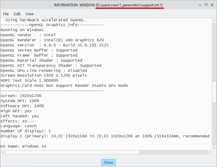

How does one start this Information Window, and where is this file support.inf.1 located

May I ask how does one start this Information Window, and where is this file support.inf.1 located?

Creo 11.0 ,,, File > Help > System Information > System Information. File location is shown in window title. See picture below.

To add to Martin's reply, the .inf file is stored in the working directory.
