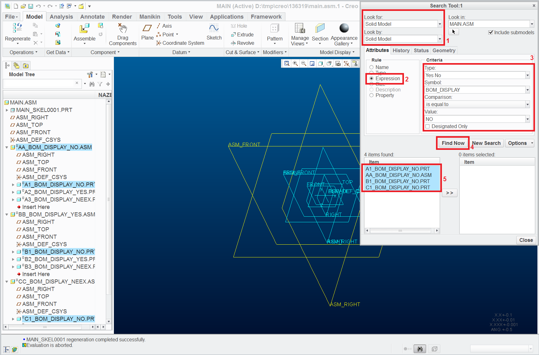

We are using Cre 3.0 Whit WindChill 10.2.
From WindChill every CAD document has is WhindChill parameter  WM_LIFECYCLE_STATE.
I need HigthLight the part on the tree structure that has this parametres equal to OBSOLETE
is It possible in some manner?
Beniamino
May 19, 2016
  • press CTRL+F to open Search dialog box
  • step 1 ... set Solid Model in Look for and Look by fields
  • step 2 ... set Expression option on Attributes tab
  • step 3 ... set apropriate values in Type, Symbol, Comparison and Value fields
  • step 4 ... click Find button
  • step 5 ... select items found
MH
